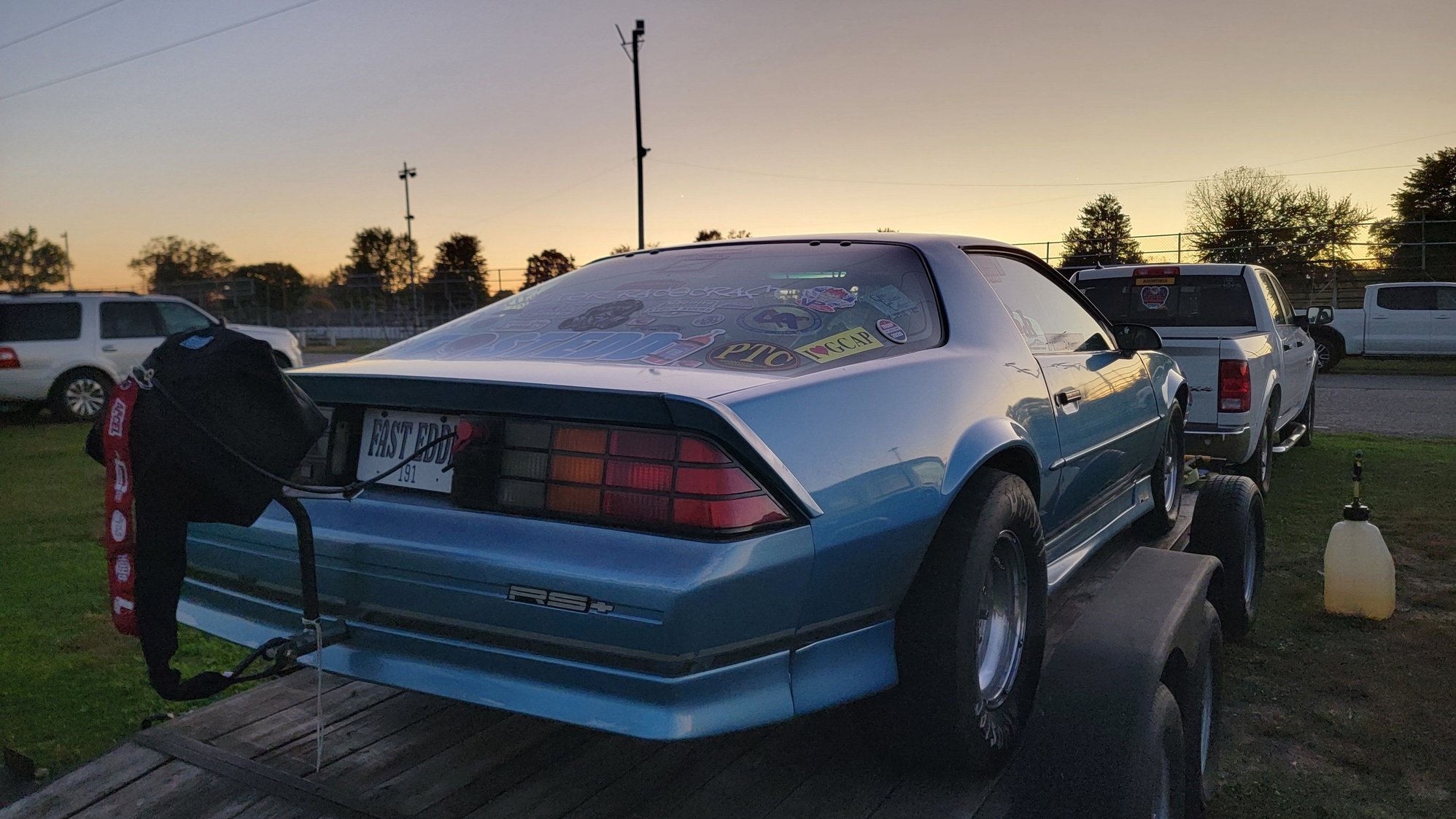

Last pass of the year. 5.52@126mph on the slip and 8.67@153mph. 1.25 60 foot. 5psig on the launch 25psi after that. The good ole stock bottom end gen 3 ls survived 87 passes so far with not one mechanical issue!
Im car number 191
Updates to follow!
