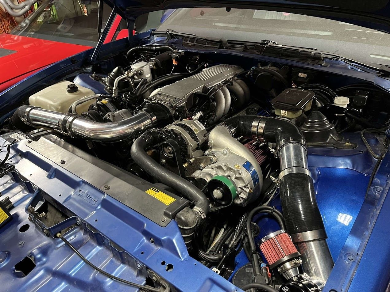

This is what I’m working with
This is what I’m working with, this was like two years ago so it’s a little different now, I did a custom 4” can that I had a friend fabricate, and yes I know it’s a lot of sh*t under the hood.

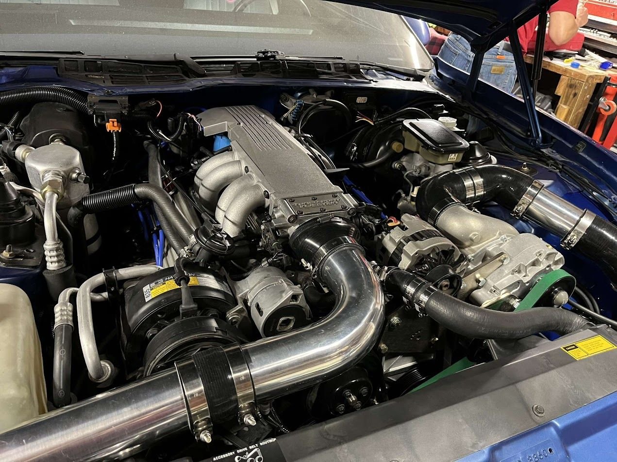

I recently installed a Vortech V3-Si on my 305TPI using the universal SBC kit (I had to modify the supercharger mounting brackets to fit it under the stock hood). I've had no issues with oil consumption through the PCV and I'm running a very simple setup.
  • I removed the breather tube/hose that went from the throttle-body to the passenger valve cover; installed a K&N filter
  • Cut the PCV valve hose that went to the intake manifold and spliced in a check valve. The check valve is pointed towards the intake manifold. This is so that the supercharger cannot pressurize the crankcase, but only pull crankcase gases back into the manifold. I am using the stock 89 valve covers that have the built-in oil baffle. It seems to work well.
I am currently only running 4 PSI with the included kit and my intercooler piping. I'm looking to go from a 6" crank pulley to a 7"/7.8" crank pulley (keeping the 3.33" supercharger pulley) to bring the boost up a bit.
