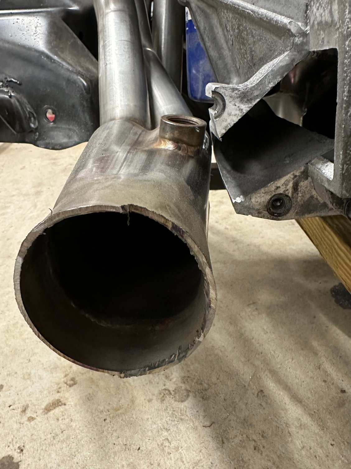

I’m doing this conversion due to large 3” header collectors wouldn’t afford me clearance to use the slave cylinder.
So I had to notch the craaap outta that mounting boss on the transmission bell housing.
I’ll post more as the time goes on, I’m installing a Ram conversion clutch for my T56 swap.
Plus I want to point my collectors just a little closer to the power train no real reason other than getting the exhaust away from the fuel lines on the driver side and on the passenger side it hits the frame pretty good. This wouldn’t be an issue if I would’ve purchased 2.5” collectors from Stainless works instead of 3”. Not to mention they don’t sell a full system for a 3”.
