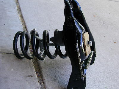

You could try something like this...
Attached Thumbnails Front-end Rebuild: spring compressors...-spring.jpg

I used the autozone compressor but had to use a 5" pipe nipple to make it work. I got the nipple at Home Depot for about a buck.
Attached Thumbnails Front-end Rebuild: spring compressors...-coil-spring-compressor-assy.jpg

A tip on using the spring compressor, make sure you are compressing as many coils as possible. You will have to get the top hooks of the compressor far up in the spring pocket were you can't see in order to get the springs out. Look at the first pic posted by urbman. To make life easier get the top hooks up another coil or as close to the top as possible. If you don't, the coils you don't have hooked will uncompress as you compress the rest of the spring and make it harder to remove. Took me two days to get mine out. An imact wrench made it easier, just don't round off the compressor bolt. Bets of luck with it.

So the purpose of urbman's and ebmiller's modification was to get the "lower" hook to grab something? Why couldn't the hook have been flipped "upside down"? I like the metal plate idea, though.
The reason I did it was the bolt was hitting the spring pod that's attached to the frame. It got really hard to turn. All it did was made the 'usable' part of the bolt shorter, same as cutting the bolt on the other end. But this way I slid the nipple off, and got my money back from AutoZone.
