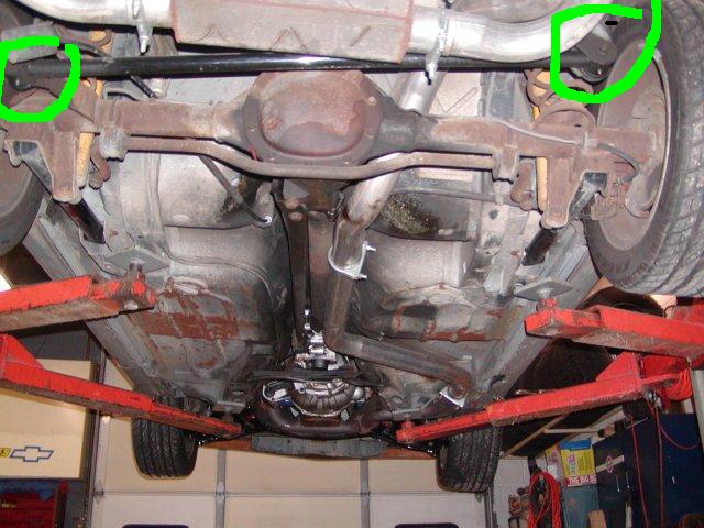

look on this page at the pic of the rear end. Its the bar that goes from the rear axel over to the body goin from left to right.Its black
https://www.thirdgen.org/techbb2/sho...ht=panhard+bar
Old Jan 3, 2004 | 08:13 PM
89cmrodriver's Avatar
Posts: 1,473
From: chesapeake va
Car: 08 Sierra, 08 Silverado, 91 z28
Engine: 5.3, 4.3, 5.7
Transmission: autos
so its this bar? anyway to tell if it has bad bushings? is it unsafe to drive it the way it is?
Old Jan 3, 2004 | 08:14 PM
Posts: 1,473
From: chesapeake va
Transmission: autos
opps forgot the pic
Old Jan 3, 2004 | 08:46 PM
Spdfrk1990's Avatar
Joined: Apr 2002
Posts: 2,972
From: Cincinnati
Yes its that bar and its really not unsafe unless ur doin alot of fast cornering. U could tell if it was bad by moving the rear end from side to side and seeing play in it

well im gonna go check it out in a minute, i hope its the panhard bar, not what agood said. I have a extra panhard bar here, the v6 and v8 ones are the same right?

the rear end is moving from side to side, atleast from what i can tell, it moves the same amount with i pull on either tire. Still need to know if the panhard bar is interchangeable

i tightened it up and it doesnt do it anymore, that was a easy fix

My panhard rod made a lot of noises but that is because I had the rod end on the wrong side. I took it off and flipped it around and everything went away.
It'll be back. When you tightened it up you're only holding the bushing with a clasp force that is completely normal to the actual forces being applied to the bushing. Trust me, it'll work for a while but will need to be tightened up every few thousand miles or less depending on driving style/conditions. Tight tolerances isn't one of the big 3's goals in auto making. The just do it cheaper than everone else and hide stuff like this with crappy bushings. At least change the bushings out with new. Also be certain that the bolt being used is a close tolerance with the sleeve in the bushing! I'd replace the bolts if they're badly rusted which many of them are. Right now I've got a loose LCA because when I installed the relocation brackets, Spohn's kit only came with 4 bolts to replace the bolts on the rear end side, not on the body side. It was really pathetic how rusted up the bolts got and how much material disappeared.

Where is it better to place a rod-end (if using bar with one end bushed and another "joint-type")? Attached to body or better to the axle?
