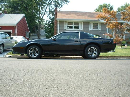

I have 26" tall tires in front and 28" slicks in the back... In my sig picture the car appears to be sitting higher in the back but in reality it doesn't look like that (driveway slants down in that picture)... I have 28" tall tires simply because I need 28" tall tires, not to make the car look "mean" or have a funky stance. Heres a crappy picture of it on flat ground... sits almost level.
I was waiting for you to post. I was actually thinking of your car when I posted this.
In reality you don't "need" a 28 inch tall tire. Unless the extra inch of radius affects your drivetrain/gears and all that much.
You could have basically gotten the same amount of traction with a 26 inch tall tire. Which means you'd have the same size all the way around.
I just wanted to know if the extra 1 inch on the tire radius was going to affect the suspension geometry at all. apparently it is not noticable, so now I have to figure out what looks the best.
I like the way your car sits, don't you? I bet you wouldn't change those 28 inch meats for 26 inch ones.
I want to stick some 28 inch tall tires on the car, and lower the car inch only in the rear to correct any, if there is any, suspension geometry changes. Plus it would look mean as hell with the tire tucked like that, you know what I mean, they do it on musclecars all the time.
Thanks for the reply. Glad you posted.
Peace, Matt

Re: ok...
Yes, 26" tall tires are fine on my car NA but on nitrous I'll run outta gear. The extra 2-3 inches (remember tire growth) put the car back where it should be in the powerband / safety zone. Plus, like you said, the taller tire makes more contact with the pavement and since it has more sidewall it'll bite better off the line. I need all the traction I can get since I'm dead set on running insane times with completely stock suspension ...I gotta see how far it'll take me
