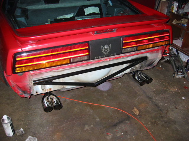

I am suprised we haven't seen more tubular peices being made by people, this is how we do it in the PNW
(not my car , i am going to be putting them in front/rear eventualy)
why?
probly because the bumper is designed for a direct center hit. and its strong in that plane..
meanwhile your tubular one is only side for side to side loads and wont do much upon impact.
