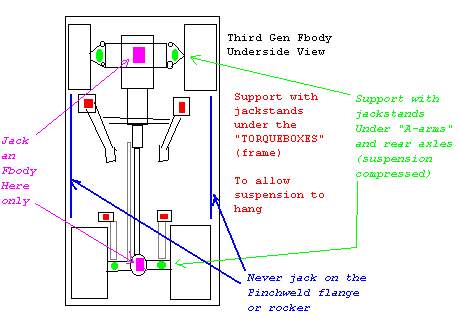

if you can find some ramps that our car can get onto. ive heard the plastic rhino ones work. dont jack on the tubes. like 25thrss said, right in the middle, on the pumpkin, and jack stands on the tubes. heres a pic someone else posted a while ago for reference

depends on your jackstands. i have some craftsman ones and they fit between the sway bar and the shock mount

To get a lot of ground clearance I drive the front up on ramps and put the rear on jackstands (either the frame or axle.) Unfortunately I can't fit my jack past the muffler when the front is up on ramps. Instead I put the jack under a shock mount to get 1 side at a time up enough to get two 2x12's under each rear wheel. Then I can lift the car by the pumpkin.
To jack up the front only I drive onto the same 2x12's I use in the rear then jack from the crossmember. If I'm just changing a tire I'll jack from the spring perch on the control arm. I don't see how people can put jackstands under the control arms and then lower the car onto them. To me the movement and angle of the control arms isn't steady enough.

For the rear, first, I block the front wheels. Then I jack the car up with a hydraulic jack under the center section. Then I slide jackstands under the rear framerails, just "in front of" the rear lower control arms. Then I lower the hydraulic jack. And I -always- stand up and bump the car with my hip to make sure that everything's sturdy. I won't get under a car unless it's rock-solid.
For the front, after I block the rear wheels, I use a jack under the k-member, and put jackstands under the "inner" ring of the spring depressions of the lower control arms. And again, I lower the car onto the jackstands slowly, and test the car before I get underneath.
If I'm raising both ends, I raise the front first, and then the rear.
