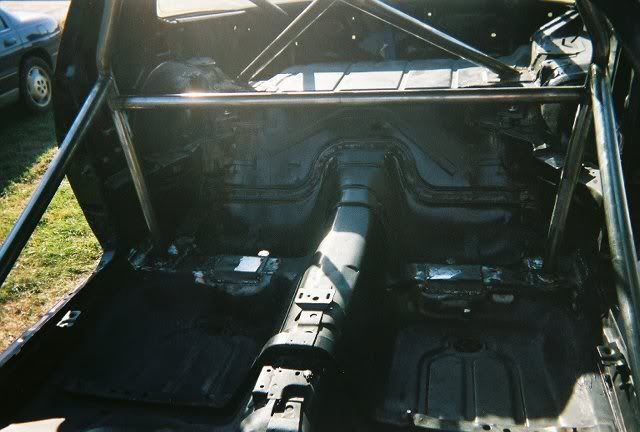

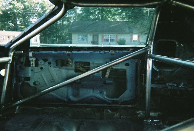

a couple more views of mine. How/where I tucked the bars for the vert, and more of the side bar and its brace.
Attached Thumbnails Post Your Roll Cage Pics Here-rollcage-035.jpg   Post Your Roll Cage Pics Here-rollcage-037.jpg   Post Your Roll Cage Pics Here-rollcage-038.jpg

Well, it actually looks like it was Kenwood from further up in this thread, which has me very confused since I was under the impression that you pretty much had to go 25.2 to be legal for under 8.50 and his pics just look like a normal 10 pt…
