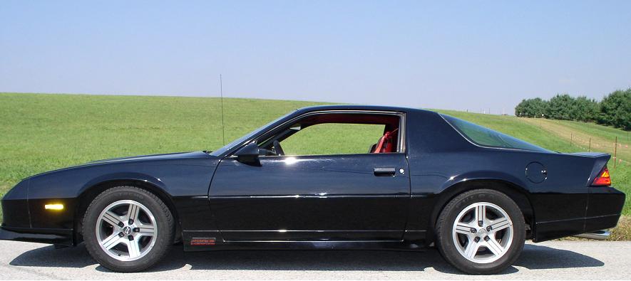

yes i have 89 Iroc with panhard bar and tokico adjustable shocks and the prokit dropped it 1.5 inch in front and about 1 inch in rear.
heres what it looks like
