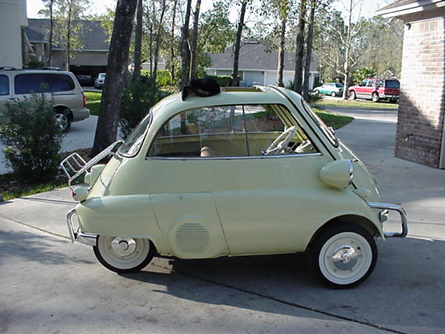

hey guys i reed the post and im sad to see that you guys are only pulling about 1.05 g. I have a proven 11.39G lateral on ths baby.............
Attached Thumbnails pulling over 1g latteral in iroc help-c-documents-settings-tony.wolfe

What, EXACTLY is that thing?
just don't pull up to close to any walls
Old Feb 13, 2005 | 01:46 PM
  #70
DVL86's Avatar
Joined: Jun 2004
Posts: 181
From: FT. Leonard Wood
Car: 85 Iroc-z
Engine: 5.0 V-8
Isn't that a car similar to the one Steve Urkel had in Family Matters? LOL!!!

yeah it is... didnt BMW make those?

Yeah, BMW did make them. I believe they where made in late 50's and it was called the Isetta.
That car looks like a big whitehead pimple with wheels.......

Its cute. kinda wanna pop it,
