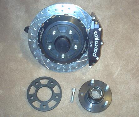

I said above I had made a wheel spacer of just over 13/16" thick (.818" thick to be exact) but the crucial key to this is it was custom made to be "hub centric". What this means is the center hole is machined to exact stepdown tolerances of my custom aluminum hubs and it press fits onto the center hub snout with is a 2.78" and then steps up to a 3.06" inside dia. Gravitational & centrifical forces applied to the wheelstuds sideways will not cause the longer studs to exceed tortional forces on the studs due to the rim being mounted 13/16" off the hub face and leverage braking the studs- because, the center "hubdenteric portion of these custom 13/16" spacers will rest "as one" with the hub and hold the stud position in tact without bind. A non hub centric spacer can fail due to the forces on the studs rather than the hub. If you llok at regular over-the-counter wheel spacers, you will see that the center hole diameter does not fit snuggly over the center portion of the hub AND the stud holes on the spacers are not a percise tight fit. You can clearly see in the picture I show below that the ones I made are pressfit onto both the center hub, and the studs without slop or possible tortional flex movement.

And the finished product.
I will also note that the rim center fits "hub centric" onto the remaining portion of the expose center hub which is 2.780"
Also I will note that those are not the ARP studs I used, those are the original 1/2" studs that GW fitted into the hubs when they made them for me. I then pressed in 1/2"x 2.970" ARP racing studs into the finished assemblies.
Everything was press fit to exact tolerances in order to run those thick wheel spacers which allow me to run 4 "rear" IROC -16mm Iroc rims on the car for rotation purposes without having to dismount the tires from the rims to rotate.
