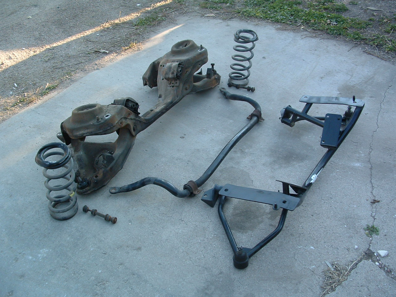

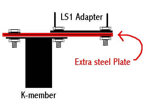

for your issue you could fix it right up with one of these? maybe Spohn or someone could get on board with a premade plate for regular k-member owners.
My whole idea behind wanting to use the regular 3rd gen mount k-member was for versatility. Using a chevy mounted k-member give you the versatility to change engine if you ever needed/wanted to. Im not just talking about a SBC or BBC or LT1 swap.
My friend is considering this swap and Im looking to the future. Knowing him as I do I feel that he might wish to install some motor not even released yet. say 10 years down the road he desides to install some engine we cant even fathom yet.
For an example I will use a fictional future engine called the LX3. The LX3 uses cylinder on demand technology, has 500 cubic inches in a small light package, makes 1000hp, gets 45 MPG (on pump methanol) and exists currently only in my dreams.
So maybe my friend wants to install one of these in his previously swapped LS1 thirdgen. He was smart and purchased a chevy mounted 3rd gen k-member instead of marrying himself to the LS1 only mount pads. Since swap mounts to install these LX3 engines in all manner of cars are being released left and right, he can simply just pick up a set and place them on his k-member.
Sadly here on the TGO site we will be seeing guys actually cutting and welding (GASP!) on thier precious (now out of production) after market k-members in their now classic third gens.
just something to think about

I think you will need some bracing for the adapter plate. From that diagram, it looks like it's just dangling there and flexing. Add a brace back to the k-member and it should be fine. The cantilevering against the bolts will stretch the bolts (cyclical loading) and possibly loosen things up, and not to mention having an engine move around too much.
Minimize the movement and the plate will work out fine, IMHO. I'm not a MechE though, other than a course or two on structural mechanics at university, so take that with a huge grain of salt.
I'd think how much bracing depends on the materials involved and the forces that will be applied.
I'd think how much bracing depends on the materials involved and the forces that will be applied. Originally posted by MrDude_1
I'd think how much bracing depends on the materials involved and the forces that will be applied. Member

I really cant speak for the spohn weights but if you want to see the weights on my 91 Z28 project they are in my post about it here:
https://www.thirdgen.org/techbb2/sho...d&pagenumber=2
the totals as scaled for just the k-member, a-arms and coil over swap as follows:
stock K-member with motor mounts, a-arms, and springs ~ 113.25 lbs
PA mild steel K-member, A-arms, mounts, and coil over kit ~ 44 lbs
I took pictures with the intent of making a webpage dedicated to the info on the swap. For those of you interested here are all my swap pics:
http://www.outlawperformance.com/ima...mods_09-25-04/
enjoy
Like I said "Buy Spohn", if I had my choice I would be running theirs now even if it meant adding a few pounds for strength.

Originally posted by B4Ctom1
you mean like the one I diagramed for him?
If you don't see what I mean, take a ruler, put it on a table with half of it sticking out and push on the end without support. The fulcrum point will be the first point of support (the edge of the table) and it will lift up on the other end of the ruler. If you support the free end of the ruler by taking a stick and bracing it against the leg of the table, it won't do that.
Posts: 4,991
From: Cheyenne, Wyoming
Car: 1992 B4C 1LE
I understand what you are saying and your idea is more ideal, I was just trying to come up with a "better than he has now" and "simple" improvement to his current situation.
