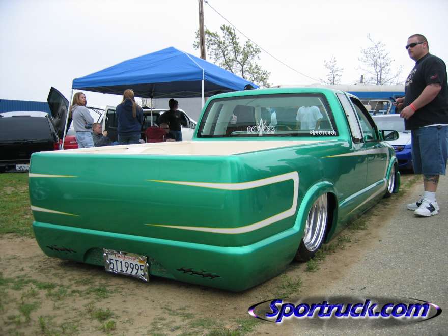

Looking at the picture below is this a step dish or flat dish.
This is what I want!

thats a flat dish....see how there are no 'steps' or bumps from the outside of the rim, to the spoked design? now look at the pic of the maro above (or crazys) and it has the little step in it
