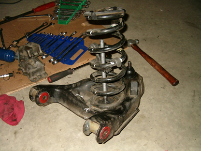

Here's a link to someone else's creativity that I used and worked great.
http://pg.photos.yahoo.com/ph/tarami...ac.jpg&.src=ph

Jeff, here's how I did mine. The pic linked earlier was from my album:
http://pg.photos.yahoo.com/ph/tarami...r=5792&.src=ph
HTH....
Ed

That's a good idea Ed....I just used about 3" worth of large washers on mine. The first compressor unit we had (just like Ed's) my brother broke...some of the threads on the center threaded rod stripped and the top hooks of the compressor flew off......I wasn't there when it happened......
Be careful!!
