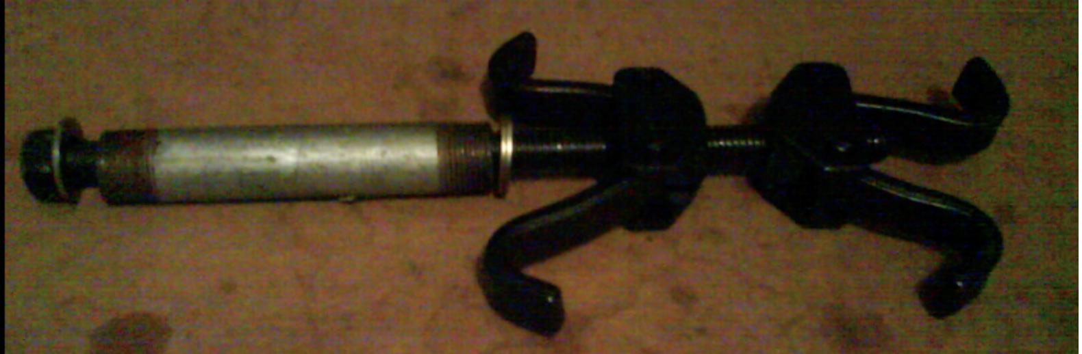

Will this spring compressor work?
92 Formy WS6, stock setup--want to replace front LCA bushings.
http://www.ebay.com/itm/1-Coil-Spring-Compressor-Internal-Coil-Strut-Remover-Installer-Suspension-Tool-/351463623436?hash=item51d4dd4b0c&vxp=mtr

I couldn't get that style to work on my 88 GTA, the stud bottomed out in the spring pocket and would no longer compress.
May have worked had the hook arms been much shorter.....

I tried that style, didn't work. Ever since Ive only used a floor jack under the ball joint. Never had any issues, and it worked good. Also never had a bad feeling with it. Never been worried it would come out. I have seen cheap spring compressors break and that aint fun. Using the weight of the car, common sense, and a floor jack worked best for me.
It works fine. Just have to cut the stud length down. I knocked off 6 inches or so.
When doing suspension springs, trick is to jack A-arm up to compress spring til whole car moves up. wrap a chain around the spring coils as tight as you can and bolt the links together. Then let A-arm down all the way. Spring will be partially compressed from the chain holding it. Then use that compressor with stud length cut down to compress it enough to pry spring out. Simple and easy

Use with a 6" pipe as seen below.
Couldn't cut on a rented tool......

That is a good compressor.
Check out this thread.
https://www.thirdgen.org/forums/susp...ml#post5268528

The pipe spacer trick James shows is one thing I've done at times. That keeps the top of the press screw from sticking so far out the top of the spring that it hits the strut tower. Another is, put the spring compressor on so that it "compresses" the control arm along with the spring; then take off and put back on the control arm, with the spring and compressor assembled to it.

Do yourself a favor and pony up the money for the OTC 7045B tool. That 30-40$ hook tool is a piece of crap. I just went throught this installing springs on a UMI k member and UMI a arms which is more difficult because of the deeper spring pockets compared to stock. I tried it with that hook tool and its like working on defusing a bomb, you never know if it will let go. It never feels safe handling compressed and it did slip while I was installing it and at that point I just bought the OTC tool. You can fully compress the front spring with ease with the OTC tool vs these hook ones which are a bear once its getting compressed down. Take care

i just used that style of compressor with a piece of pipe as mentioned earlier. The pipe I used was 3 1/2 inches. Worked flawlessly.

I used one just like the item pictured in the original post. It worked great time and time again until the one day it failed. NOT COOL ! I had it in the spring and the spring was compressed. I pushed the control arm down with my foot grabbed, the spring with my right hand and pulled it out. I turned and took a couple of steps away from the car and it felt like getting electricuted. The tool let go for no good reason. The spring did not have anything to launch from so it remained in my hand. I am absolutely terrifed of this job now. I checked out the OTC version and it dose look to be a better design. Please always use caution when working with coil springs.
