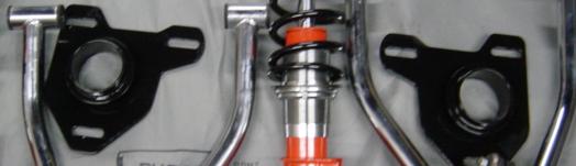

i would highly recommend investing in something like this and a strut tower bar if you haven't already.
art morrison makes these particular versions but you can find others. roughly $50 for the pair and help to distribute alot of the pressure. they mount right underneath your strut tower stock, doubling as a spacer and proper upper spring support. really made a difference in the ride after i installed them.

FYI.... Art Morrison wont sell them separate any more only as the kit $700 I talked to them about a month ago.BMR makes mirror copies of them but I never got emailed back if they will sell them separate either.
