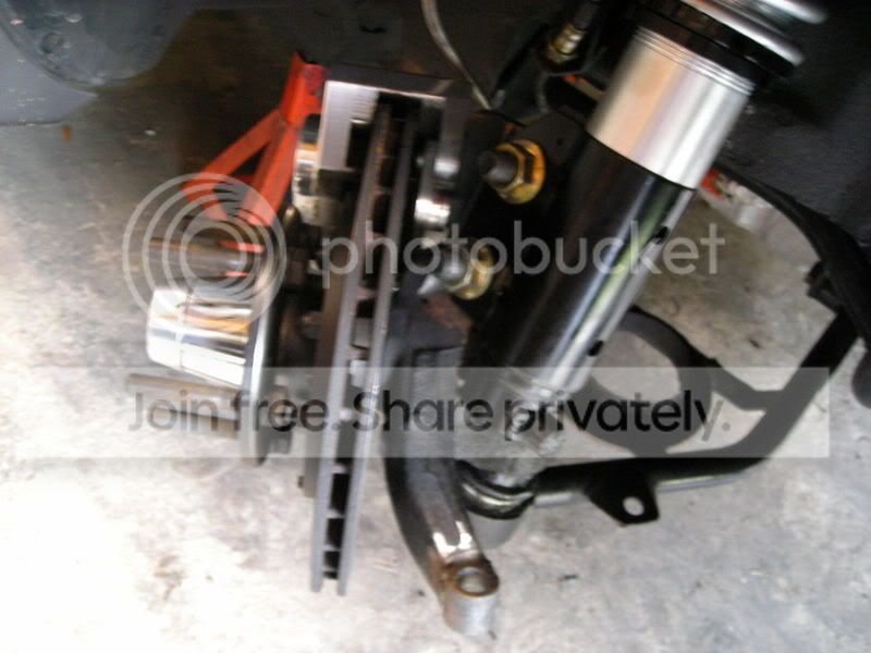

mustang coilover front struts/rear shocks installed. pics.
yes.... they will fit a camaro with a lil machining.
chopped the spindles to fit the smaller width pattern of the strange strut.
the spohn strut plates needed the bushing knocked out and a 5/8x3/4 one pressed in.
the threads needed to be hit with a die on the fronts because they were not threaded enough to fit the camaro type strut mount.
the foxbody strange rears are only 60 bucks. great alternative to a leaking 160 dollar qa1. and they almost bolt in like a stocker.
the shock tube is too large to fit a stock mount, so youll need to use a madman type setup and they should be a direct bolt on. i run some panhard rod clevis that are welded on. few bucks cheaper than the madman, and serve the same purpose.
the lower mount had a bit of steel i had to hit off with a grinder. it stuck out longer than the rubber bushing. it may have been just my set, or they all could be like this.
havent quite got it rolling to see how it all works out.
still have to fab up a few things to get the pinto rack put into place.

That's really cool, those strange shocks look great! and a great pic of your steering arm mod too.

stage20 - You and I talked about this before. Good to see you got it all sorted out. I still highly reccomend putting travel limiters on with those strange front struts. You don't have to cut down your travel range, just let the cables catch just before the struts. I know of 3 stang guys on their 2nd+ sets of those struts due to the internal piston breaking loose from the rod. Haven't had any come apart, but they start making a clunk/bang noise and loose their adjustablility(stays full loose, no matter where the **** is).
Nice job on the steering rod alteration for the rack. That came out very clean and looks like it has a nice bit of surface area to get a good weld.

it sits 27 1/4 inch from the ground to the fender lip. i am running a 28" sportsman front tire if that info is useful to you.
After seeing the new pricing, I'm glad I got in on the initial run of those vari-struts. Jebus! I was still looking to get another set, now I think I'll go your route.
thanks for what help you offered me. got me in the right direction anyway.
i finally just went out and got all the stuff and started hacking. no looking back!!!!
the car actually turns in a tighter radius than a stock steering box.
not quite as good as an s10 manual box, being it has no steering stop in it.
with skinny tires, i could just about turn the tire 90 degrees with the car.
those alstons are nice pieces, but im glad i went this route.
as mentioned above, if i wanted to do a set of santhuffs, i could pick up a set of those, or any other mustang strut slightly used or even new from a swap meet. they are more common than the 3rd gen stuff.
thanks for the comments!

[QUOTE=stage20;3951245]i imagine your car is a bit heavier than mine in the front... well, i dunno. i have a 6.0 iron block. its 215 pounds. added 75 pounds to the car over a sbc.
i run a 14" 150 pound spring. its set 1/2 from coilbind. ive got a pretty good amount of street miles on it and rides better than stock springs. i only have about 6-6.5" of travel vs my 8" with a drag coil spring.
my car could still be lowered more if i wanted to put it in the weeds.
I dunno, I have not wieghed it lately, I would imagine it`s close to stock or less, a/c heat deleted inside and out, front bumper and plastics out, manual steer box, manual master, electric water pump, paper thin glass hood, 9 inch converter,th350, tube k member and arms, coil over conversion..I`d be willing to bet it`s lighter than stock. I`m also running 28`s moroso ds`2 and my fender lip is 27 inches off the ground.

Stage20 - how much shorter than stock did you go on the steering arms? I've got a set to do soon.
You guys talking spring numbers helped my mood for the day. I'm trying to finish up our 10.5 outlaw car for a runday sunday after thanksgiving and I haven't been able to fully set-up the car on the springs. I have a set of 14" 175# and I was thinking I might have to next-day in some 200's or 225's after this weekend(final assembly) to be ready to race. - Sounds as though the 175's will work though.
Old Nov 18, 2008 | 06:18 PM
stage20's Avatar
Joined: Jan 2004
Posts: 2,311
From: p'cola FL
Car: 88 iroc-z/28
Engine: 408 lsx
Transmission: 5800 stall
Axle/Gears: 4.71
Re: mustang coilover front struts/rear shocks installed. pics.
my front end is 1740, and a 150# is perfect for me.
i measured a buddys mustang spindle from centerline of ball joint to centerline of tie rod and did my best to make them match up. i got within an 1/8". not bad for homebuilt stuff.
make sure you order a std length rack and not one for a camaro, or the drivers side will be too short???? im guessing here, but makes sense.
i wanna say the deminsion was 5.5 or 6.5" but i am not for certain.

I'm going to use a t-bird rack. SAE tie-rod threads and regular inverted flare fittings on the hook-ups(vert will be power, radial car will just be manual).

I'm more interested in the rear setup. So you bolt a "y" looking thing inplace of the shock stud that we have. And it fits?
pretty much. you can buy the shock relocation brackets from madman, or use a panhard rod clevis bracket from a 4 link kit.
my steel tube inside the rubber bushing on the lower mount sttuck out way past the rubber. i took the belt sander too it. could be all the sets, or just mine.
