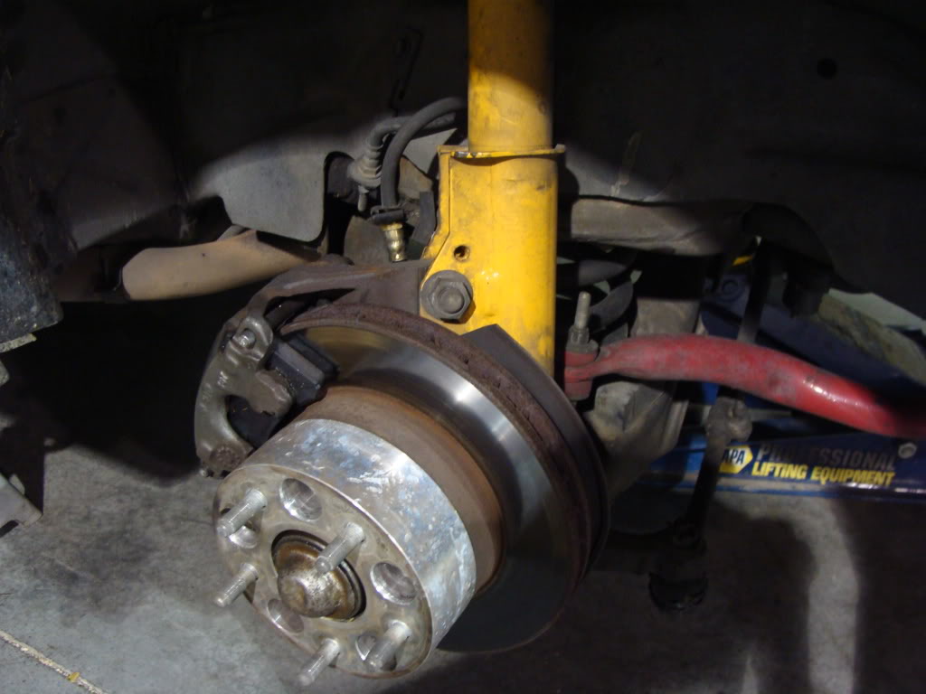

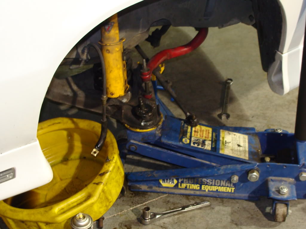

Ours is a 'modified MacPherson front strut'. Here's a shot of mine with the spindle off the car...talk about a nasty under-carriage. You can see the Yellow KONI in the foreground and the black spring in the a-arm behind it
And a shot with the spindle in with stock brakes-

Sorry, I missed you edit- You have to get whichever spring compressor that works on the inside of the springs I think. I don't remember as I've never used them. I'm sure someone else will know though.
