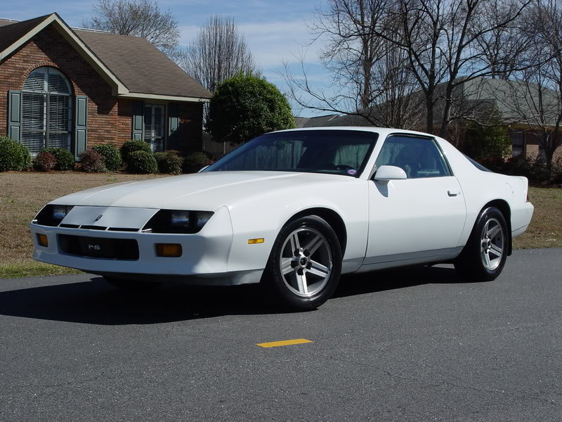

here's a picture of ride height with 1 coil cut off the front v6 springs with my iron headed 305 i had in the car for years:
with iroc wheels:
with mickey thompson et drag fatties/skinnies:
and my "new" ride height isn't much different honestly, even though i figure i took 150lbs off the front of the car
