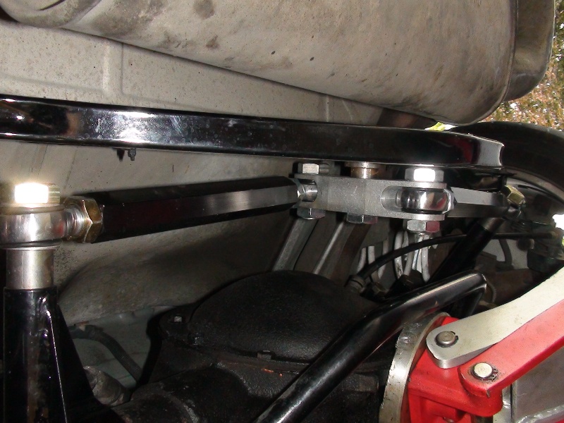

Recently installed one & love the results.
Thought I would toss up a few pictures if anyone is interested.

Is that a direct bolt-it? It sure looks like it is.
Where did you get it, how much did it cost, and how much does it weigh?

You can get them from Sam Strano.
They are basically a bolt in. The only mod is to grind off the brake line clips from the rear axle housing.
Takes a while to set it up exactly as you have to adjust the link bars on the car for equal angles & length, but I got it done in approx 3 hours.
Cost was $650, not sure of the weight. It added prob 15lb or so, but I would gladly add another 15 if I could get the same amount of improvement again.
It eliminates the jacking effect that the rear typically experiences in hard cornering. I daily drive my car.... no rattles, clunks or additional noise. The rear feels more stable with the watts link & I can push it harder before getting the rear loose.
I'm very glad I added this to my car.

If you like to corner hard, it is an excellent addition to a street car..... that is all mine is. I drive it every day & love to nail the turns.
Wheels are 17x9 American Racing. They do not fit without substantial modifications.
The watts link makes the car more consistent as it does not tend to pivot on the panhard bar. The pivot point is now in the center of the car. It now feels the same in a right & left turn. Rear body roll is substantially less.

Wanted to say thanks for the pictures. Gives a much better idea of how it all fits together.
I too do not like the jacking when turning one way and the pull/roll in the other direction. A reinforced panhard with poly bushings helped. But did not eliminate the excess jacking.
Looks like it does a decent job of clearance for the exhaust, true?

Anyways, You are correct that the pivot point remains the same consistant left to right being that it remains centerd laterally and does not yaw the roll axis like the panhard will...
,,However, with roll center heights being set equal from the panhard to the watts, the car will roll more on the rear due to less yawing of the roll couple and less leverage holding down the inside rear chassis of a corner.
Panhard rear roll centers will migrate towards the greater spring rate favoring that side of the car (there are a few other factors here that influence roll like panhard length and lateral angle static and dynamic, but asside those for now). even if the rear spring rates are equal on both sides, you have one side increasing with lateral squat and the other side for the most part releasing and lessening due to body roll- as well as te compression velving dynamically increasing the outside overall spring rate as well as the rebound valving increasing the inside overall spring rate@ turn-in and corner exit. Thus, the rear roll center will cimgrate dynamicallyttowards the outside of the rear of the car (as said prior yawing the roll couple) and creating more inside rear chassis leverage wieght against roll.
the watts eliminates any yawing affect and causes more predictable rolling left and right, but does in fact reduce leverage and can through physics created more roll pound for pound. I still would choose the watts any day over the PH bar, its just that a prior balnced car will need to be re configured with spring rates, roll center height, shock valving and swaybar setting when the PH bar is removed in place of the watts setup.
As long as motion travel is reduced in this "reverse watts" design (I know, I have done alot of banter a few months back abvout this design on Frrax to Sam Strano' disliking, too bad, I merely state facts- with that said, as much as Steve spohn and I are good acquaintances on these boards and I taked with him many times aiding knowledge on designs and just giving "my opinion" sometimes to him privately on designs, I have even not been a yes man with him publicly on the front coilover setup not being very street friendly. Steve took my advice on the Torrington Bearings to aids in that problem but still does not make it completely street friendly,so.... ) this design does not retain the rear end in perfect center under the car in susbstantial rear suspension travel of massive body roll or the combination of the two. It is best to have the conventional Watts design (no reverse design) with the pviot being on the rear axle, not on the chassis side. The pivot on the axle like traditionally designed makes for the rear axle to articulat over road pefections freely as the body is in roll motion and keeps the rear centered- this reverse design does not.

Also, this design is strickingly simular to the Mumford Link design I came up with back in about 2002 and posted on here finally in about 2006 because I mentioned something about the watts not working. Its why I engineered a Mumford with this same chassis brace and axle mounts.
I applaude someone for actually doing a rear chassis support setup like this in some fashion, I unfortunately never came up with the means of getting mine built. Just when I acquiared a milling machine and lathe I ended up in a nasty divorce and life has changed- I actualkly no longer have that 3rdgen I had then either- yes, she got it, but luckily my daughter is driving it so it wasn't sold (they do not live near me). Someday I will hopefully have access to that car to tinker with again, it was a fun car and I miss it.
Dean
I do not have the link, but if you search here under Mumford link it should come up. I had a different name then (actually many of them- long story)

Here's the link: https://www.thirdgen.org/forums/susp...d-linkage.html
This design is basically a "Reverse Mumford" which can suffer the same high travel affects as the watts, but the link arms can start more paralell to thee suspension atriculation of the rear axle since both sodes come off the bottom instead of the pivot coming off bottom and top on the watts. It can be set more paralell in static setup thus more appropriate. My higher bar setup is also utilized for another top secret setup to follow so that strainght flat chassis bar has mulitple uses.
Also note that this is designed for all out racecar sh*t, so don't give me any greif about dual exhaust routing, dump that out behind the front right tire under the car. Saves two things, polar weight, and prevents exhaust gas cooling routing it so far tot he rear.

The watts link is working well & it does act differently than the panhard for sure. I had an oversteer condition before, that was also brought under control. Lowering the rear roll center further, I can get it to understeer & also with significantly more body roll. I'm sure with more rear spring & bar, the lower roll center could also be an advantage. I may play with this next. I'm still running the roll center in the top 2 holes.... still unsure of which I like best with my current setup.
With the panhard, I could feel the car roll & rear inside tire start to unload & then it would oversteer. Obviously stiffening the rear shocks made it worse (they are at full soft). Going to a smaller rear bar, let it corner faster with less oversteer & handle better... even though it did not feel as stable or predictable. The watts link gave me the predictability I was lacking before.
