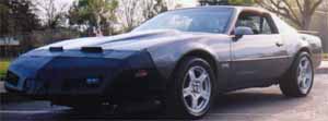

p.s. Here's a photo link of a '91 Formula with C5 rims (17s front, 18s in rear). Like I said, LOOKS cool, but this guy's wheelwells probably chew on his tires periodically!
http://www.skulte.com/TmyhreC5rim.jpg

p.s. ...perhaps I should've said 'this guy's wheelwells probably chew on his tires periodically'. Gotta admit though, those C5 rims do look cool on that Formula...
</font>
That's Trevor's (BLOWNWS6) Formula. He bought those wheels cause he got a deal from his boss who was selling them off his Vette. He has spacers and they fit fine. At first the outer side wall was getting scraped in the rear because of a metal "lip" that is on the inside of our 1/4 panels. After he rolled that lip in (basically just smoothed it out so it didnt protrude) they were fine. No more rubbing and bad a$$ looking C5 wheels on his Formula.
Also, C5 wheels werent meant for thirdgens and arent popular additions to them. With ZR-1 rims you can get perfect spacers that make them fit exactly.
Also, the 315's on the 17x11 ARE Viper size.

p.s. Here's a photo link of a '91 Formula with C5 rims (17s front, 18s in rear). Like I said, LOOKS cool, but this guy's car probably handles like pure ****!!
Check it out!!
</font>
You have NO clue what you car talking about. You are confusing "ride" with "handling". For example: A Caddy rides like a dream but handles like a boat, a 4thgen Z28 rides and handles good. A WS6 thirdgen will handle better than a stock 4thgen Z(not SS) but it won't ride better.
