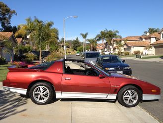

I have using Pro-Kit for 4 years now... very happy with the look, performance and comfort... But never used sportline though.. I have two Trans Ams. One with stock (Gray) and the other with Eibach Spring( Black) have side by side pictures, if you want to see the difference.

The Sportlines are awesome, mean stance and ride firm. My car does not bounce, at all. It handles better than my 2001 SS Camaro, but of course I have a full UMI suspension to include caster, camber plates, SFC's, Tubular panhard bar and LCA's. I would like a better ride, but before I can really say they are too harsh I need to play with the adjustment on my Koni shocks and Struts. The ride quality reminds me of a C6 corvette, firm but not rough.
Attached is a pic of my IROC with stock wheels to show what how much the Sportlines drop the ride height. I can tell its lowered, as the front fender sets over the tires.
