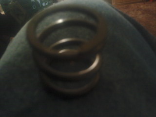

so i was fixing my slack on my tilt and got all good to go but ups i forgot to put this spring on any one have a clue where it goes

It goes behind a silver cap with a square hole.You have to remove the wheel & the c-clip, plus a few others.That cap is on the upper portion of the column.I think its what make the tilt wheel spring up.

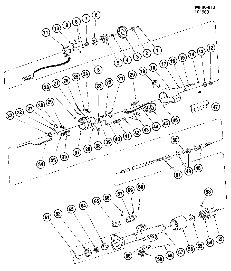

I think its the one that goes on the colum to provide press against the hub..but it could be the one fro the tilt aswell..hard to tell from a picture.
maybe this helps......

I just thought of that too.It could be the one that directly behind the canceling cam.Either way gotta remove the retaining clip.

thanks for all the fast replays and the pic. the spring is number 7 on the pic.

Thats what i thought...so go ahead and get it all back off..SORRY !!!
