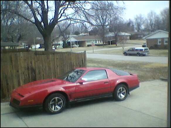

Well I just got a new cat back fabbed up and put on and I'm very happy with it, but I'm not happy with my fender gap. On my sloped driveway sitting uphill, the front driver's side fender is sitting at 28 inches, the front pass. side is at 27.5 like it should be, and the rear fenders are at 28 driver and 28.5 pass.
The car seemed like it sat lower before I took it in. My fist used to fit snugly in between the tire and the fender on both sides, now I can move it freely in the driver's side gap though the passenger side is still about the same.
Before...acceptable
Now...4x4
Since then I have loosened the sway bar end links and rolled the car back and forth and I've driven it a bit, with some of the driving taking place on really rough roads. It still hasn't settled and it has me scratching my head. I tried feeling the springs to see if they were indexed properly but I couldn't really tell and I didn't really worry about it because I figured only cars with suspension work need that checked.
So does anyone have any idea what could be wrong? Could the spring really be out of index just from the car being on a lift? And if so, can I adjust the spring just by lifting and supporting the car and yanking on it, or do I need a spring compressor?
Thanks.
Joe

Welp, got it figured out: went under the car today to wipe some of the grease off and noticed the sway bar got jacked out of place. Loosened the end links and the points where it and the wonder bar attach to the frame. Tried shoving it in the right direction and it wouldn't budge, so I put a paint stir stick up to the side that was off and hit it with a BFH... all is well now and it's as close to even as a 26 year old car's going to get.
I hope this thread helps someone else, but man I'm ecstatic that the car's not seriously messed up.
