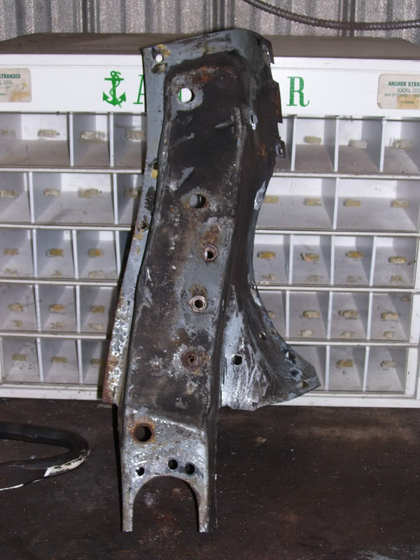

Is this the piece you are loking at replacing??

Do you mean a subframe or a front k-member?
The subframes in a third gen are not easily replaced. Unlike a first or second gen where they are bolted to the body, a third gen subframe is part of the body. Third gens are a unibody. If a subframe is damaged then the car was in an accident and needs to be straightened on an alignment rack. If the subframe is rotten then the body is typically scrap because the cost to repair can become much higher than what the car is worth.
If it's just the k-member then it's simply bolted to the subframe. Factory ones are not going to be found except from a junkyard but there are many aftermarket tubular replacements.

Thanks 6SIX6 that looks like a front subframe piece. My front subframes are still in good condition, what I am really needing are rear subframe pieces. I am hoping to be able to restore the car, for sentimental reasons not to increase or sell it.
Attachment 376618
I am looking for these I need both right and left sides do you have or know a site I can visit to get a pair these are what the transmission cross member attach to correct
