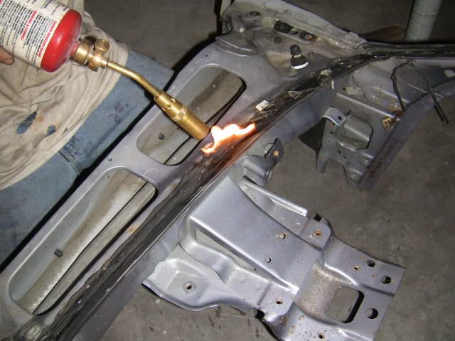

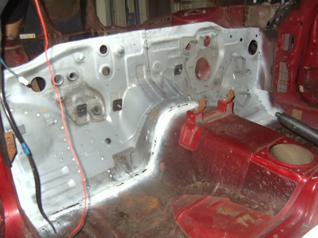

These should give you an idea, not a thirdgen, but an example of disassembling a unibody car:
Cowl area, cut out then being disassembled.
http://i239.photobucket.com/albums/f...d/IMG_4969.jpg
All of the little dots along the edge are spot welds removed

Firewall removed
http://i239.photobucket.com/albums/f...d/EPSN5820.jpg
