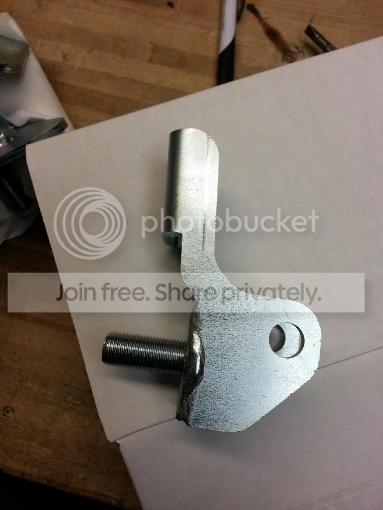

Our upper plate is 3/16" thick and customers are welcome to weld it.
The teardrop design and double shear is dictated by the shape of where it is mounted.
Ramey, I would HIGHLY suggest you refer that everyone weld it. The single bolt hole area (*OEM shock bolt location) is outside the strength of the spring pocket. Now all the weight of the car's rearend is directed right into those single bolt holes on each side of the rear chassis rather than on the stronger OEM uper spring pocket. By not welding that plate to aid support for the location next to the hole. the force will still be driected to the hole and the other end of the plate will in fact eventually teeter totter and progressively wobble faster and faster the more slop that results. It will come on quickly and then flop over and the OEM shock hole will punch right through. That plate has to be welded.
by making the plate larger, it gives a more spread out area to stitch weld the plate into the chassis sheet metal and not overheat the area trying to be welded- thus of course buckling it or even punching through it with excessive heat buildup when trying to weld it.
I would put 4 tacks about 1/2" llong around the centter circle and about 6- 1" welds around the perimeter of the wider plate style like spohn is showning. He laser cut the production run 10 years ago to fit exactly into the can area. My prototype was done by hand and almost that large but not as percise.

stitch weld installation example
Attached Thumbnails UMI Releases New Product- Bolt-in Rear Coil Over Kit for the 82-02 GM F-Body-coilover-plate2.jpg

wtf? This is a needed part. Welding it would be cheap insurance.
The factory rear shock mounts pulled out on my old z28 after I installed kyb's. I had to weld the area up. Just because you have never seen it happen doesn't mean it has not happened.
Having an entire coil over in the same general area? Your going to need to beef up the factory shock mount.
STG's suggestions are valid.
Read that and had no idea what arctic was saying- but from your interpetation it sounds like he is being condesending to me. Resaon I do not post here much anymore because too many childish *******s
I gave some first hand knowledge to UMI. If arctic doesn;t want to heed my caution for safety then he can find out the hard way.

We have a few other bolt-in parts that we recommend welding. I plan to do the same for the instructions included with the coilover kit. Sound advice.
Thanks Dean.
Thanks Dean.
ramey
As always, I am always here to help with facts and safety, and people spending their money wisely. I appreciate your courtesy. Please just understand the flucrum that develops with the double shear mount onto the plate as this oem hole weakens- the fulcrum will develop at the base of the mount nearest the edge facing the large side of the plate. The plate will then rock if not welded. As it rocks, the shock force will be dirrected off center of the OEM mount and the fulcrum will increase upon every compression and rebound stroke cycling it.
I hope I explained that comprehensively - I sometimes confuse myself in re-reading what I am trying to describe..lol
If a chassis is in good shape, this will last a while before this ultimately happens, but once theOEM bolt hole starts to elongate and this area presses upward, the fulcrum that develops will rapidly set in and failure will be quick. You will obviously heere noise back there, but the average person is not so savoy to jump right into diagnostic then stop the car and tow it home.
Unlike a conventional shock, this area is now holding the complete weight of the rear chassis. Failure would cuase the car to drop and an accident could easily ensue. As midnight stated above, this has happened may times with the use of airshocks that up the value of how much thethis area hold the chassis and reduces the spring carrying load.---however, the springs are still in tact upon failure of this area with an airshock. This is a coilover, with no more conventional spring to fall upon. I would still recommend 100% weld instulation.

I have a question regarding the upper mount. Like Dean said welding would be preferable when installing the upper mount but couldn't holes be drilled in all four corners of the mounting plate.and it be bolted in that way?
Old Mar 28, 2014 | 03:03 PM
  #66
UMI Sales's Avatar
Joined: Jan 2009
Posts: 745
Likes: 30
Re: UMI Releases New Product- Bolt-in Rear Coil Over Kit for the 82-02 GM F-Body
I'm sure Dean will chime in but I'll mention. There's a bunch of folds up top there that are hard to get to. You could drill the holes easily but they go into a cavity that you can't access...

UMI Guys,
OK after much deliberation over selling my Z I decided to keep it and install the Viking coil over kit. I have installed the kit as part of the replacement of my rear end. I do believe the upper bracket will tend to rock fore and aft in service, I can see it moving to some extent with me under the car horsing on it. Remember these cars are the flexible flyers. First off guys interested in this kit asked about welding in the upper support bracket, if so the spring/shock assembly is no longer serviceable. There is no clearance to remove the upper shock bolt. I believe this kit needs a little more engineering to remove the welded upper shock mount from the upper support bracket so it can be welded in the spring pocket then the mount is to be bolted through the bracket and original shock hole. There was a question about bolting the bracket in (with this kit a better idea). You mentioned drilling into an inaccessible void. There is a weep hole in the center of the original spring pocket. I am going to investigate using a hole saw to open this hole to access the upper void to install about four bolts around the perimeter of the bracket. The bracket is 3/4 inch wide in this area and with 1/4 bolts it has enough material to still have fastener diameter edge distance. This may be a viable solution to this issue.
UMI Releases New Product- Bolt-in Rear Coil Over Kit for the 82-02 GM F-Body-p5100063-1-.jpg
Otherwise I am going to cut the shock mount from the UMI piece and bolt a new mount through the support bracket so I can weld the bracket in the car. I agree with SlickTrackGod and others on this thread about the issues involved.
This is not really a big deal to me at this time since the car is down for an LS1 engine upgrade and I am restoring a lot of the car. I don't plan on driving it for about a year.
This is a pretty nice kit but I feel there could be a little more engineering to be a great product, I bought this over the Spohn kit because his lower brackets were not as quality a part as I felt yours is. If you could combine your lower bracket design with his weld in upper bracket you would have a well designed kit.

UMI Guys,
Attachment 277223
One question I have: When servicing the car on a two post jack can these shocks take the abuse where the suspension hangs out of the car. I have been careful to support the axle since installing the coil over kit but Joe Bob at the tire store will not be so careful.
As with any 1st design product, we are always learning and considering upgrades (although far away at this point). Think iPhone 5 --> iPhone 5s.
We routinely let our cars hang by the shocks when up on jack stands but don't abuse them when doing so. I'd have to check with Viking to be sure. Of course the more careful you are the better. We've never had a problem.

92BLKL98's Avatar
Joined: Apr 2001
Posts: 798
From: Powder Springs, Georgia, USA
Car: 1992 Black Z28 Hardtop
Axle/Gears: 2002 10 bolt w/3:23
ramey
OK Ramey, how 'bout this, after spending a little time under my Z tonight I realized bolting in the mount to be too much on the car. Either 1. I cut through the original spring pocket and then a second hole through the sub frame to access the top side for fasteners, not an option. 2. Cut through the upper floor pan for access, um no. or my preferred: 3. You guys send me a pair of upper bracket assemblies without the welded on shock mount (at no charge to me) for me to weld in the car with a set of shock mounts to mount the coil over and I send back the complete upper mount assembly I have. As it stands like it is I agree with you about 1st design products, time for version 2 of the design.
One more issue you need to look at the hole that fits around the spring pocket, it needs to be opened up maybe 1/16 of an inch or at least chamfer the inside to allow the bracket to lay flat against the spring pocket for welding otherwise getting a sound weld is difficult.
