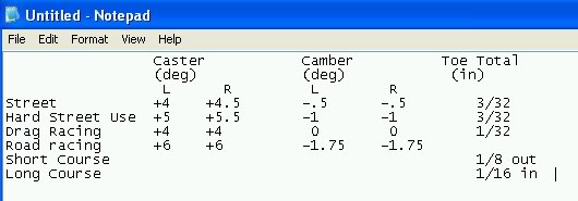

these are excellent specs. i would find a shop that will align it with precision to whichever of these best fits you cars usage.

Infernal - YES!! That is what it seems like! I'll make some adjustments on both sides to straighten it out. Maybe pull the toe in just a touch since I think it is at 0, and that does not match what Plum posted. Thanks guys, great help! I've had trouble finding another shop to do good alignments, one most can't get the car on their rack, and two most places won't touch it cause it is lowered. I don't mind tweaking it though, so this is a great help.
