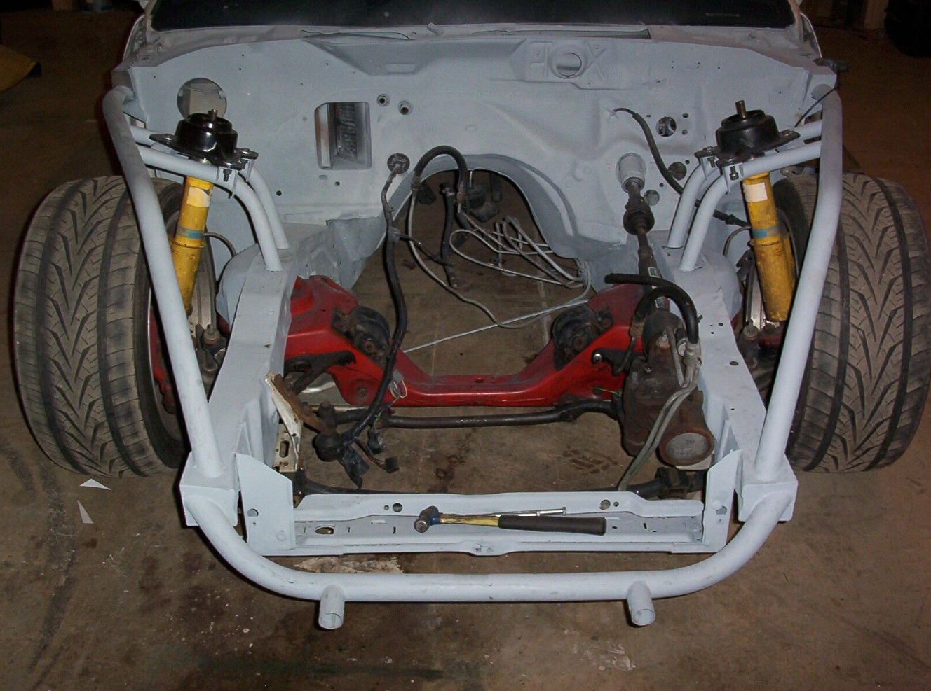

Looking for the front suspension guru's with my question(s)....this has been/still is a long term project. Going to put my car together with the upgrades I have, so I can drive/enjoy it for now. But the plan is to eventually (once I have all the tools and space sorted out), tare it back down and shoot for the moon. I'm not competing in or on any particular level, just trying to build my dream and give some exotic car guy's bad dreams����. I am going with a custom built 2x3 front rails, tubular front end... keeping the car and strut based setup and going with adjustable coilover struts.
I'm looking at moving the entire front suspension forward 3", (to include the strut towers). The question is: a.) Should I set the towers at the same angle and height? Or b.) Slightly alter the angle and height to achieve better camber/caster?
Thanks for your time and input, best regards.
Rick

Sounds like you're reinventing the wheel. You'll be changing wheelbase, weight bias. These cars have a lot of short comings in the front from factory. Ackerman is one example. More caster would help but stock is hard to get more than 6°. I'd you're not familiar with terms like ackerman, you need to study it and Steering Axis Inclination, roll center. You want to go through all that work and fabrication, might as well do it right or it will be a waste of your time and money. These cars handle well and can easily be modified to hurt a lot of feelings. I'd be impressed to see how much, if any, a guy could gain redesigning the front end.
I wouldn't use coil overs in the front of an autoX or road race car, the strut towers were never designed to uphold the weight of the car, but for street or strip UT seems to be ok. Tubular k-member and a-arms only cuts weight, no strength gain.

Thanks plum, not really trying to reinvent , but I am trying to greatly improve the weight distribution of the car. I've seen a few car's that have gone to a tubular front clip, but, they kept the strut towers and suspension in the factory location. I am not building my car purely for looks, or just because I think that it is cool. (Don't get me wrong, I love my TransAm), but I have specific goals in mind.
The engine/ trans is also being moved aft 9" (so you know), I'm not sure just how much of the weight bias I can shift with these mods... but, I believe that I can achieve a much better distribution with them, than not. Dream world, my ideas will give me a 49.5/50.5 distribution (so, as the fuel is burned off, the distribution gets to be more even...or better).

As for the strut towers and coilover's... with a tubular support system and thicker plate to mount the strut to... I'm hoping that it will strengthen the strut suspension to handle the load... of course, if I'm wrong... you're more than welcome to post an "i told you so" in my obituary
Old Jan 23, 2017 | 04:21 PM

I don't know who this guy is, but the work looks really solid.
This amount of movement will cause a lot of issues with component fitment unless you widen and raise the transmission tunnel. It could also make shifter placement into a manual transmission an interesting proposition. The BMR tubular K member moves the engine back 1/2 inch and it makes fitment tight on the transmission with the stock tunnel. With the use of aluminum in a lot of the front end with a tubular k member and a stereo box in the trunk, we got weight to 53/47 front to rear on the factory suspension points with a Gen 1 SBC under the hood. With the aluminum LS setup currently in the car being set back 1/2 inch, I suspect the distribution is even closer to 50/50 now. And we do road race and autox the car heavily while keeping it comfortable to street drive as well. You can achieve a lot of your goals without the amount of fabrication you are thinking of doing.
If you're going to go all out and strip the car to a race only setup, you should have no problem getting the weight bias you want without setting the engine back that far. Battery to the trunk. Aluminum LS engine with no AC. Tubular crash support in the bumper. All of these will help with the weight bias with far less fabrication required. But if you do fabricate what you are thinking of doing, post up a build thread so we all can get ideas from it.

Beater79, I appreciate that. Any chance you can get the car scaled and give some #'s?
That would really help me in deciding weather or not to do this.
I will still be doing the tube front clip, but more like the picture I posted... providing that I can achieve the weight distribution goals. But, your information has she'd a bit of light on the subject, so, I'm willing to listen

Old Mar 23, 2017 | 10:49 AM
z28cp's Avatar
Joined: Jul 2002
Posts: 32
From: Bellevue, NE
Re: setup for road race/autox?
If one was to go to that much effort, why wouldn't you make it a double wishbone setup? Get rid of the strut.
Old Mar 23, 2017 | 12:58 PM
rb85TA's Avatar
Joined: Sep 2014
Posts: 474
From: south central Texas
Car: BUILDING 1985 HARD TOP T/A
Engine: sbc
Transmission: stick
Axle/Gears: GM
probably for the same reason(s), that I wouldn't...
Already have to much money invested in things like, drop spindles, 3rd gen tubular lower A arms and tubular k member, etc...
Combine that with the fact, that with the hood closed and the car sitting on the ground it will have a modified look... but still look like it's a 3rd Gen.
