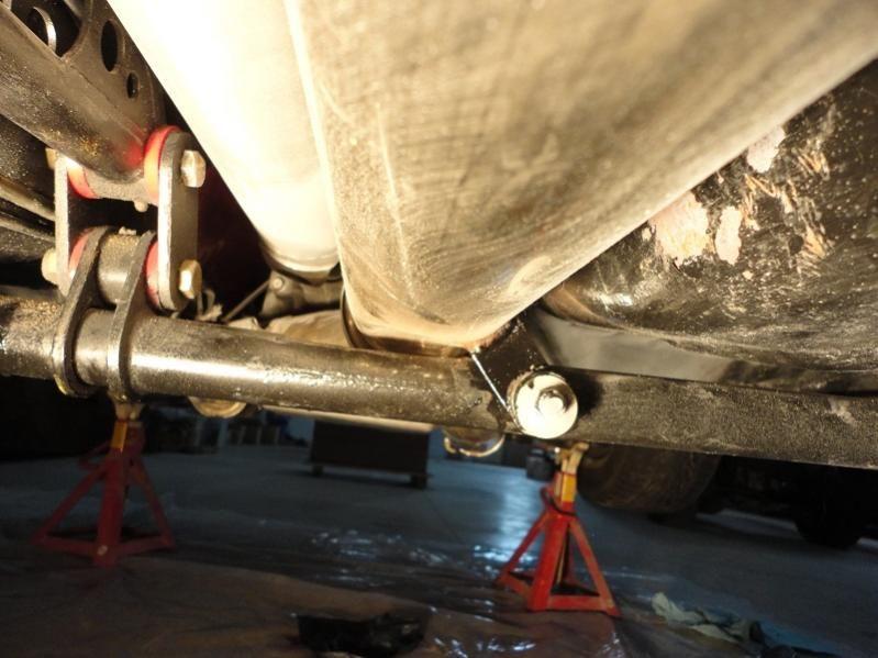

Thanks for responses so far guys! Zach is right about the Alston SFC's. Here's a pic right after I installed mine (prior to t56 swap).
