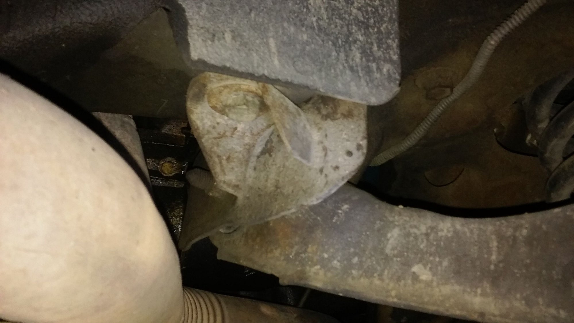

Passenger side. rear part of the controll arm?
I noticed on the passenger side control arm? the rear side of it has got what looks to be newer welding? i noticed a small crack on it. maybe that could be the culprit.

Yep, another control arm is in order..... And DON'T take it back to either fool that couldn't spot that.

Yep looks like you need another control / A arm.

I got back under the car today to replace my brake pads and i noticed that the crack isnt actually on the control arm? do these cars come with upper control arms??? cause i believe it looks like the actual cross member is cracke. how much of a pain would THAT be?..... lol

No, they have struts on the top, take another pic while pulling that rubber flap out of the way, in the pic you posted it sure looks like the control arm that's cracked....
