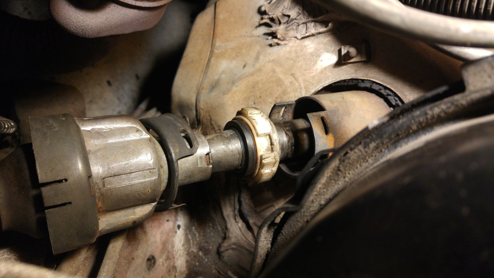

The idle arm is a Mevotech. The upper strut mounts have never been replaced but they look okay, at least when I look at them from above.
One of the first things I looked at was the steering shaft in the engine bay.
There's something like a bushing where it comes through the firewall. With someone rocking the steering wheel back and forth the bushing wobbles pretty good.
Also, I can grip the steering shaft in the bay and easily rotate the column with my hands between about 11 and 1 o'clock. None of the movement transfers to the pitman arm, so it seems like the slop is in the steering box. If that's the case, is it possible/better to rebuild or replace?

I rotated the part of the shaft on the steering box end. The shaft goes up to some kind of boot (is that the rag joint?). The play is not between the two sides of the shaft, they rotate together. The car was off and I was able to move the shaft very easily.
There's a plastic cover at the steering box end where the shaft goes in, I'll have to take a look tomorrow.
I've actually adjusted the steering box before. It was at the point where the steering hung up in the middle, but it was still totally loose.
The picture above shows the boot thing on the left and the firewall bushing thing on the right (disassembled).

Any reason you took the firewall bushing setup apart? I didn't catch your last sentence in your post and originally thought it fell apart and was going to say thats your problem lol. But either way, if all else looks good, new steering box time. They aren't too expensive either. I believe you can get the quick ratio IROC box from the parts stores for around $125. Just make sure you have your old one for the core. I think the core charge is pretty steep on them.
