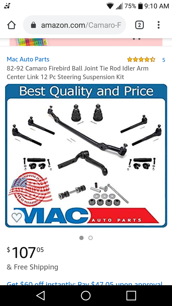

What do you think of this set? Has anybody ever bought this kit?

I think I bought the $107 kit you show from Amazon. The idler arm was an exact match for my OEM one. The components looks sturdy but the castle nuts they provide are crap. I stripped two out not even torquing them. I reused my old ones. Much better.
