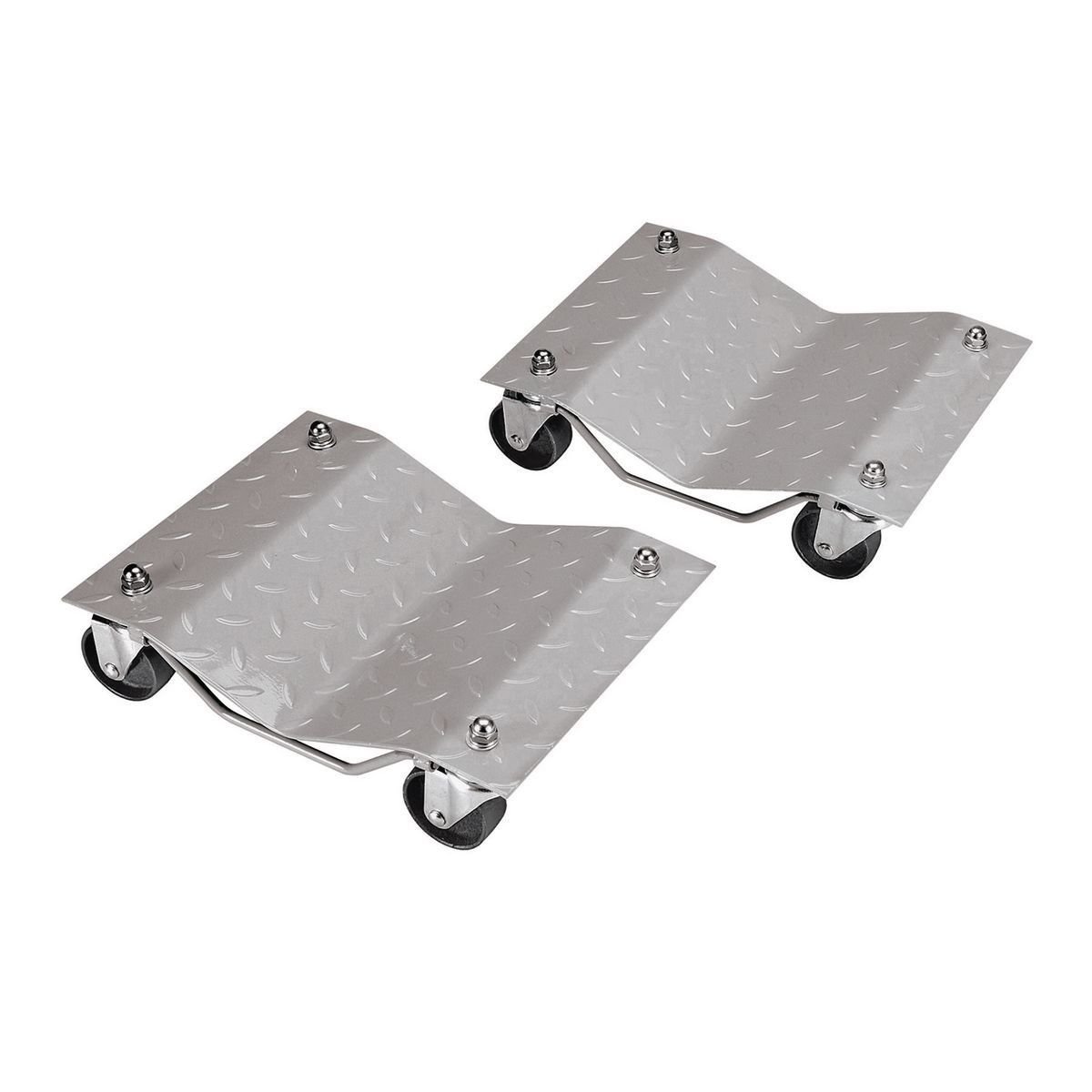

I might just put it on curved wheel dollies instead. My car has all kinds of gnarly dents underneath from sitting on jack stands long term. Problem with jack stands is that it just isn't flat, and eventually the car is going to conform to the shape of the pad.

https://www.harborfreight.com/1500-l..._q=wheel+dolly
Use a 20% off coupon and buy them one pair at a time. I use them.
I wouldn't leave the suspension unloaded for too long and jacks under the front torque boxes would allow that to happen.
Subframe connectors short term also work great for jacking and jack stand locations. I welded some simple ones on my Camaro.

You know, I actually wondered about this. I've read how twisty these cars can be, especially convertibles and that I really need to get some SFCs, so I wondered if I didn't have the car jack standed perfectly, would the frame twist over time?
I've seen those wheel dollies before but I forgot about them, I didn't know they were an option. Using these won't **** up my tires? I spent a lot of money on those bad boys and I'm not rich, so I just want to take good care of my baby as much as possible lol. It's a little late in the game, I leave in a couple weeks, but i'll check these out and the shipping times tomorrow morning.
