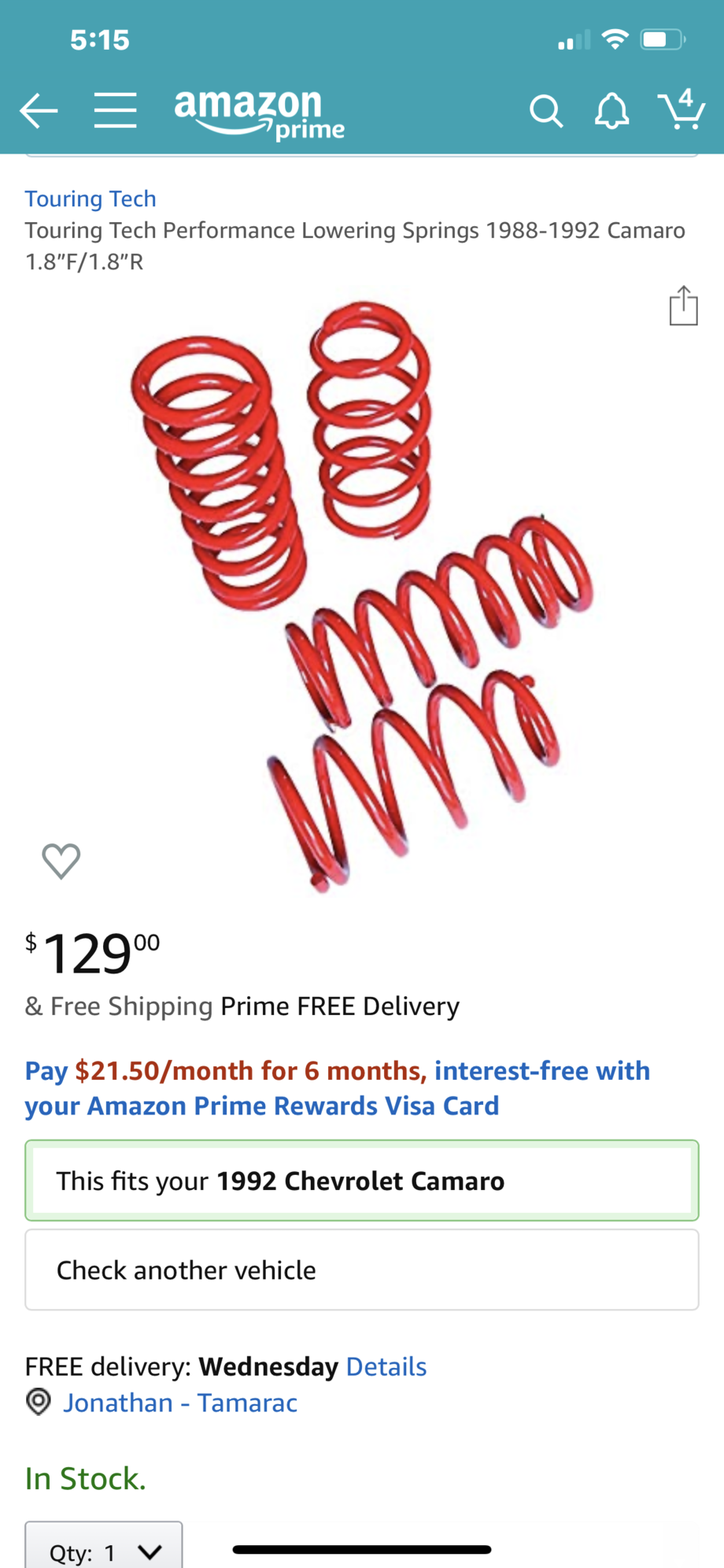

Ended up ordering these. Price is a bit low and hopefully I don’t get what I pay for! Or I do? Haha. It is just temporary anyways. Car has been in storage too long want to get it going and enjoy it now during winter time here in Florida! T-topless!

Spend the $$ for UMI. Great springs. Sporty ride, but not harsh. Lower about 1"

I have installed Eibach Pro kit on two cars and I love them. Takes the car down about an inch. Had them on 84 Z28 and now on 91 Trans Am.
