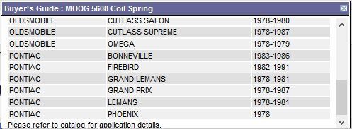

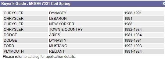

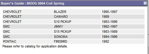

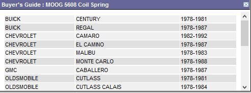

The real problem is all the replacement MOOG springs are fairly generic "one-size-fits-all". They aren't even thirdgen specific. If you look up on Rock Auto and click the part number you'll see all the applications the part number is listed under. You'll see things like Blazers, and S10 pickups, El Caminos, Malibus, all kinds of cars. And people wonder why the ride height is dramatically different when you replace a very specific factory spring with a generic replacement...
Lololol I noticed that. It's crazy sometimes how one part number can have so many different applications. Here's a funny one for you

WRT to the MOOG springs Drew hit the nail on the head, the MOOG springs are pretty much generic springs that are close, though what I don't know about that is how much overlap there was over the product lines originally. For example, our front LCA's were used on other cars, so were our rear control arms, many other GM cars had the same size spring pockets and it was common for GM to go into different model line parts bins for parts. They are not "this is what it sat like at stock ride height," heck, as the years went on factory ride hight got lower on the same option package cars, and if you look at an original '82-84 car they sat like a 4x4, and I've posted pics of my '87 TA with stock springs in it that don't appear to have sagged (they have correct tags on them, no idea why they haven't sagged like others) you won't believe how high it sits, were the '90's cars look like they're lowered from the factory.
