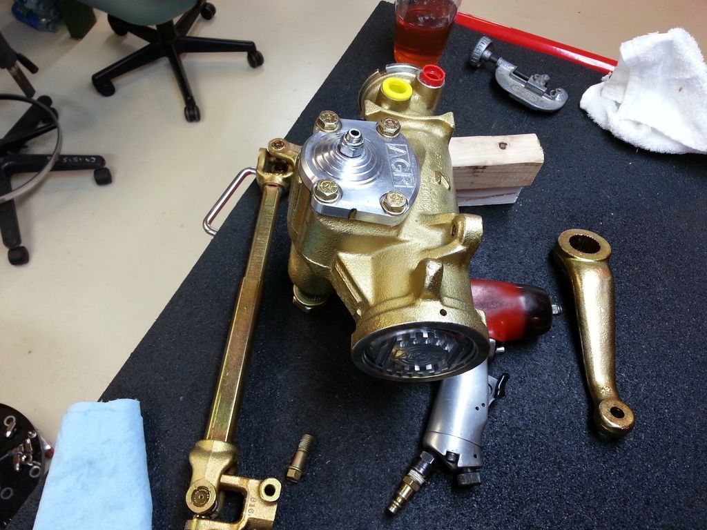

AGR custom build unit. from one of there older units..had to send it in to them. has the standard GM kit did not have all the parts that AGR has..
Don't know if they make the trick Billet caps any more..as this was a older unit I had gold Zink plated before sending it to AGR for them to put it back together test. and sent back to me.
