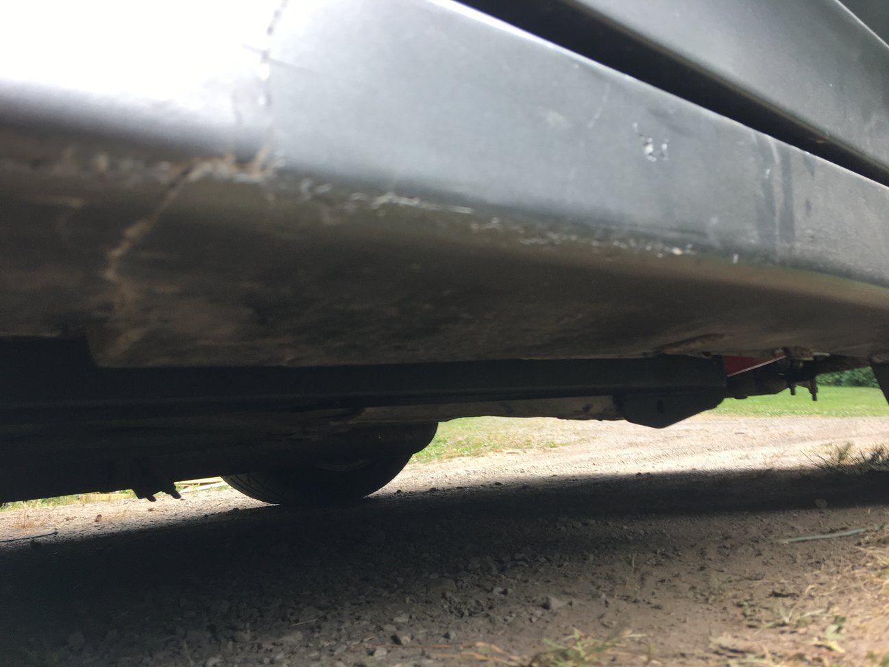

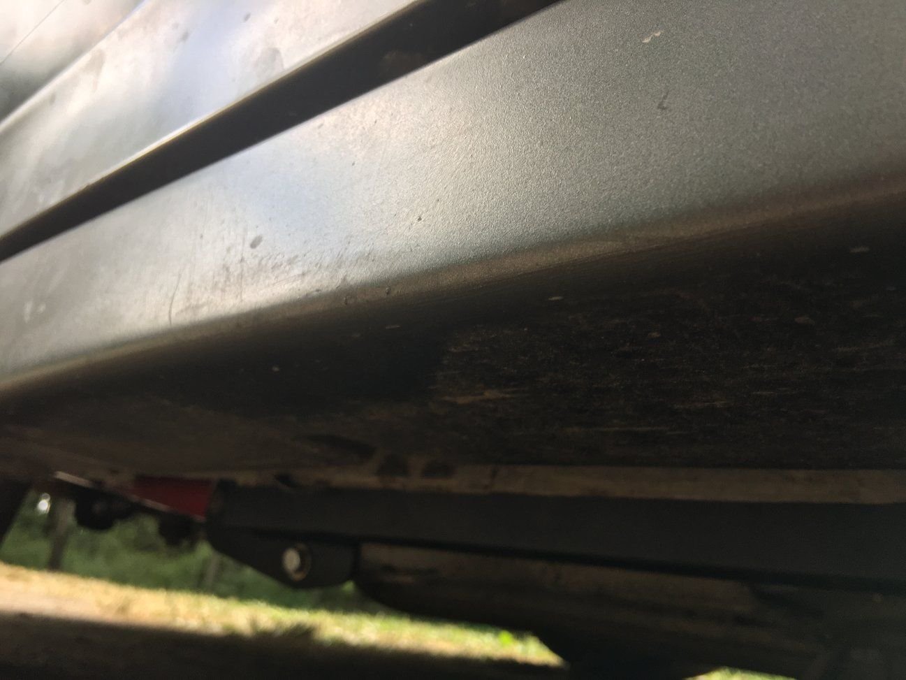

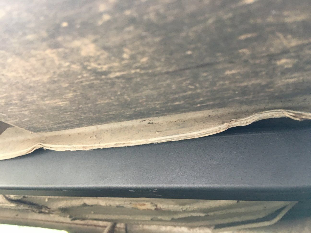

How low are they when looking at the car from the side. Anyone have a pic or 2?

You can't see them from the side at all. you can see the rubber strip that runs under the side of the car but not the connector

Just so I'm clear, do the bolt-in SFC's from Jegs use existing bolt holes?
I have zero interest in welding anything to my car and I'm not keen on the idea of drilling new holes in the underside of my car either. If these SFC's are easily removeable and the car can be returned to original condition I'm very interested...
Old Oct 7, 2020 | 11:55 AM
Fullmonte77's Avatar
Joined: Nov 2018
Posts: 249
Likes: 117
From: Kylertown,PA
Car: 85 Berlinetta
Axle/Gears: 10 bolt 3.42 with Torsen posi
Re: Subframe connectors
They use existing holes where the rear lower control arm mounts. You must drill the holes through the floor in the front and bolt it there. No welding required at all! And they could be removed if you wanted but would have to either weld the holes you drilled or put bolts in those holes.

What are they actually bolting to, once drilled through the floor? Just the pan?
Old Oct 8, 2020 | 07:06 AM
  #43
Joined: Nov 2018
Posts: 249
Likes: 117
From: Kylertown,PA
Car: 85 Berlinetta
Yes just the pan. Some people say the holes elongate others have had no issues. Some people will weld them in too. Big thing I guess is your floors need to be in really good shape or it's a complete waste of time and money.
Old Oct 10, 2020 | 02:15 AM
  #44
FAST LiFE's Avatar
Posts: 221
Likes: 11
From: SF, CA
I've ran these in my previous IROC with no bolt elongation issues. I haven't had of anyone actually show me that issue yet either.
