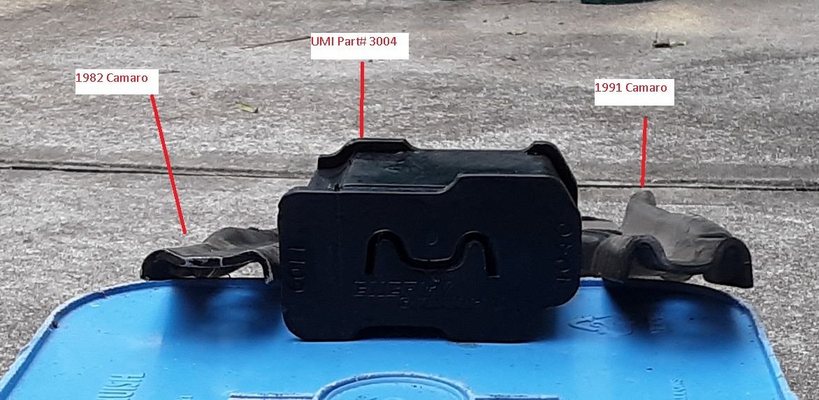

They say a picture is worth a thousand words and this picture tells the whole story, but for the sake of those doing a text search the thousand words are below.
I have the original torque arm from my '82 Camaro. I am in the middle of installing a UMI torque arm relocating transmission cross member. I like the cross member by the way.
Everything was going fine until I tried to mount their "universal" torque arm bushing (UMI part # 3004). There is no way it will fit. I might be able to force it on with a vise and a big hammer, but it isn't something I could do under the car. Even if I did manage to FORCE it on, I would not say that it "FIT", more that with enough effort you CAN put a square peg in a round hole. The picture above shows my original 1982 torque arm, the UMI 3004, and a 1991 torque arm that I had laying around. It fits on the 1991 torque arm without issue. It slides right on like it is made for it.
It does not fit my 1982 Camaro torque arm.
I'm going to install the 1991 torque arm and move on. But others might not be lucky enough to have a spare torque arm laying around, so be warned, the notion of a UNIVERSAL urethane torque arm bushing is a myth.

I think its just your torque arm, I upgraded to a UMI adjustable torque arm years ago and still have my original 84 sitting in the corner. Looks to be just like the 92 torque arm you have

That is exactly my point. There were at least two different designs, but I think that there was a third for the 82 to 83.5 cars.
In any case the bushing is advertised at fitting 1982 -> 2002 cars and it does not fit my '82 properly.
I've owned the car since it was new so I'm pretty darn sure it is the original torque arm.
BTW, I've heard that the early vs late third gens have a reversed bushing pattern, that they are mirror images. I suspect that the SUPER EARLY third gens (like mine) may have a third pattern. But I have only ever seen the two shown in the picture in person.

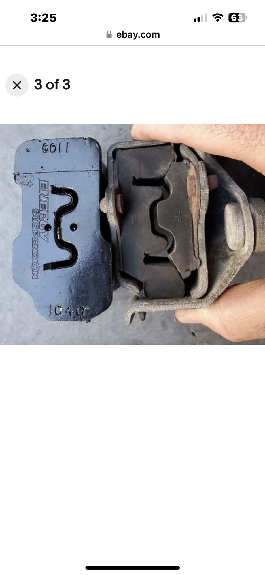

Off to ye old junk yard to see what treasure awaits…always little things cause the biggest problems. But look at this, side by side comparison. Sooo clearly UMI is way to big to use without a ton of brute strength and lots of bad words. Picture below is NOT mine

The picture is deceiving. The part inside the clamshell looks to be about the same, but the UMI has an extra "flange" on the face that extends out of the casing. You can see the cutouts on the sides to let the parts of the metal bracket extend past. Looking behind that face and you can see that the busing itself looks to be the pretty close to the same size.

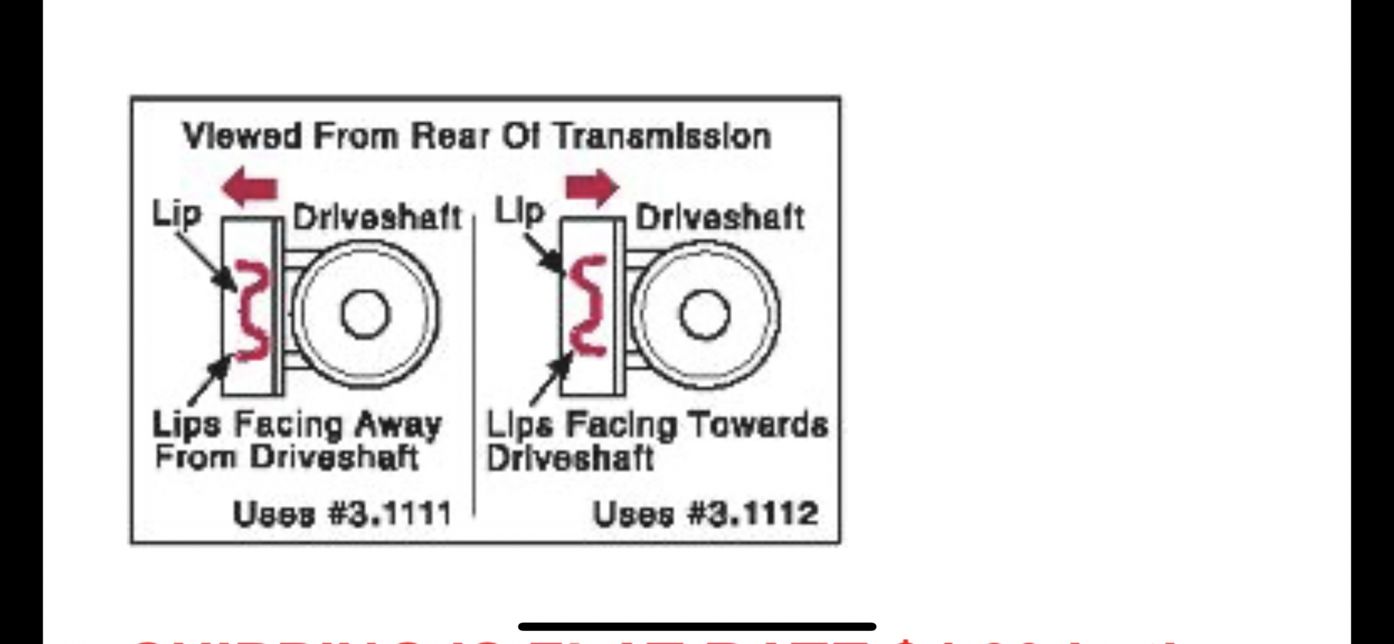

If you look at my first post, those two torque arms are both facing the same way (same orientation).
My original torque arm would not fit either of those bushings, but would be (IIRC) closest to 3.1112.
3.1111 must be for the third type of torque arm.
