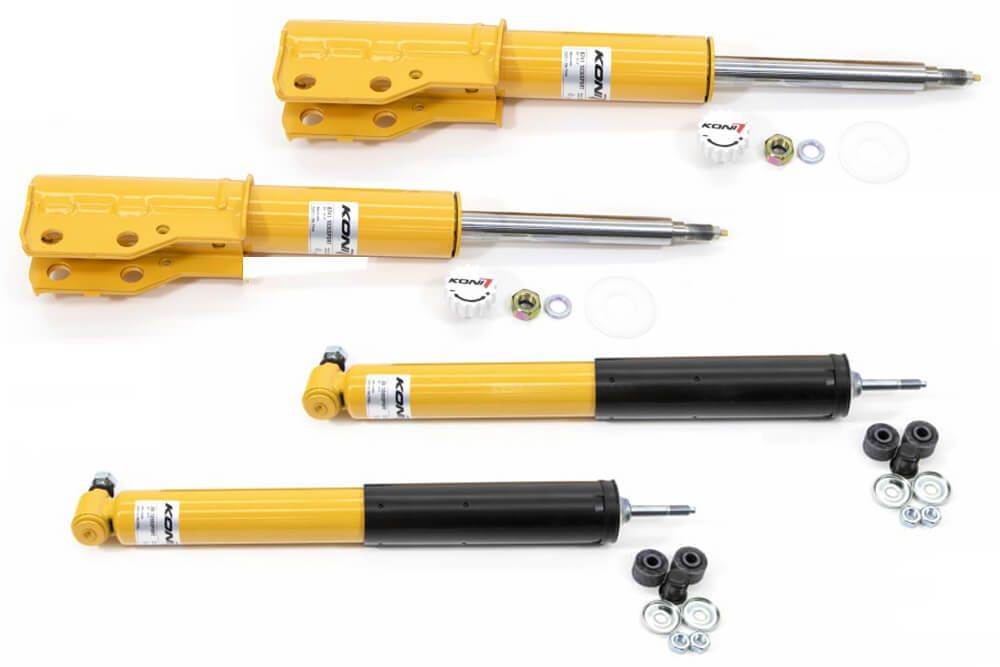

Koni yellows...

Koni yellow struts and QA1 single adjustable rear shocks

Koni yellows are about $870 for a complete set, they are adjustable so work great for a daily driver or track car. If that isn't in the budget KYB makes stock like shocks/struts for about $150 for a set. Not a whole lot of options in between those two. We sell the Koni yellows, they have a on-car adjustable or off-car adjustable rear shocks, the $870 price includes the off-car adjustable shocks.
1982-92 Camaro/Firebird Koni Adjustable Struts & Shocks (screamingchicken.com)
