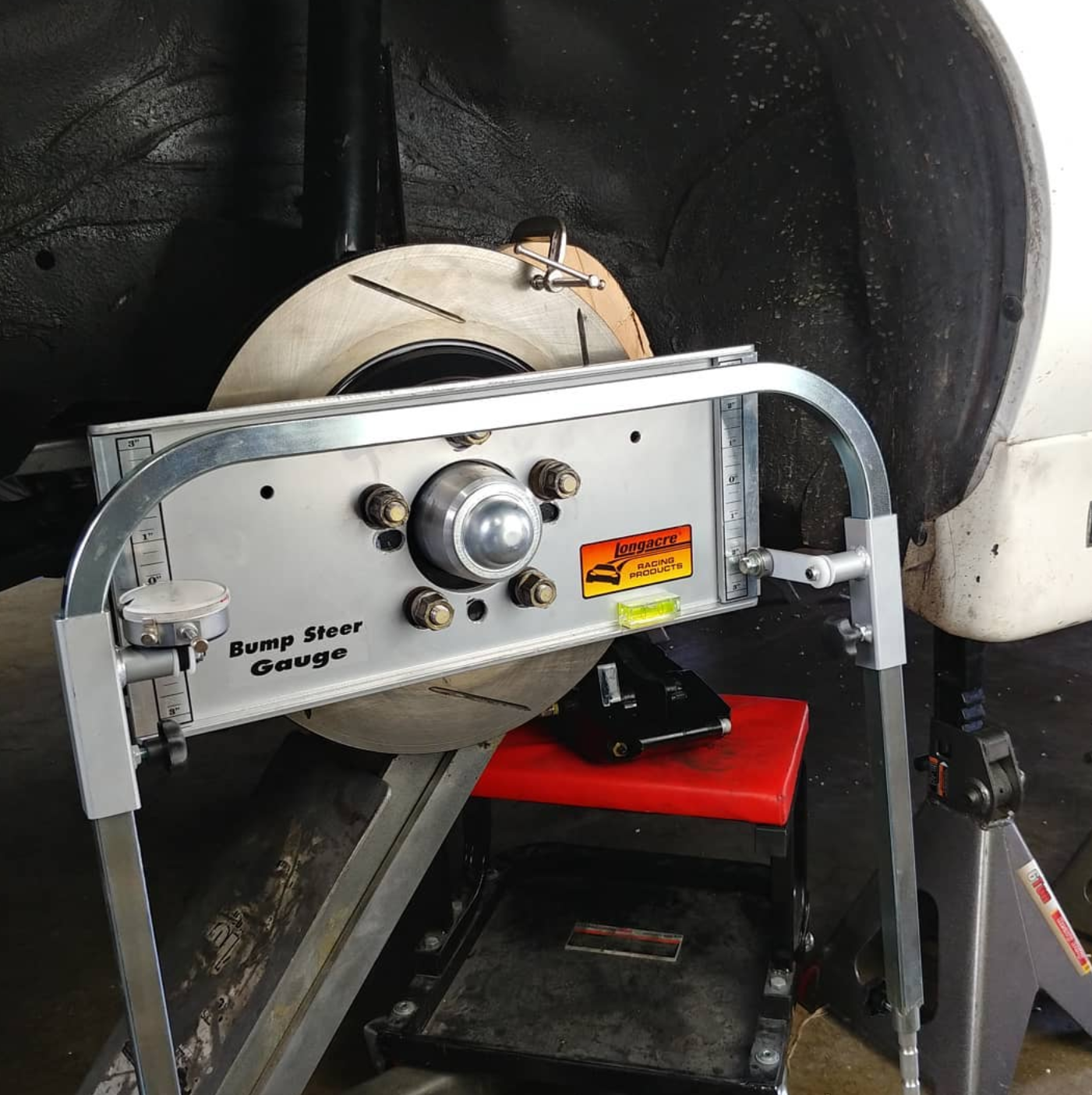

bump steer when lowered isn't that bad on 3rd gens.(I've tested bump with a gauge a LOT of times)

1/2in extended Ball-joints will give you about 1/4in of bump steer with a stock setup.(yikes!)
I managed to get my bump to 0.002in at 2in of travel and 0.006in at max drop or compression.
Makes the car far nicer to drive around without the car wandering all over the road.
But just lowering a 3rd gen won't give you unliveable bump steer like many claim.
