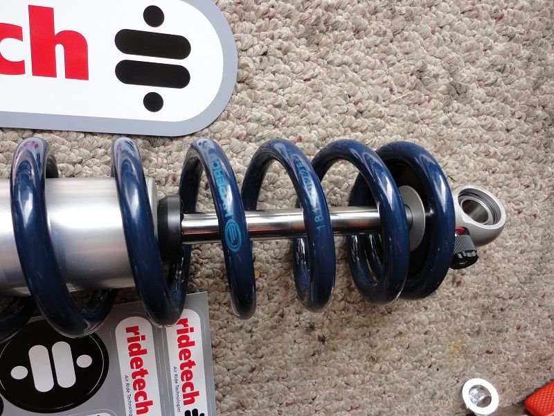

Hey TEDS, With your weight-jacks, what did you use for isolators on the front?

It's just heater hose split open and zip tied as in the pic, a little grease added too. Works fine.
