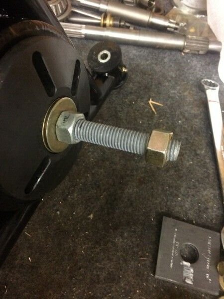

Well, I tried using the spring compressor to clamp the spring down to the a arm and then lift it into place. Just no friggin' way to get the arms aligned and get the bolts in the bushings... Gave up and put the bolts in with the a arms hanging down.. But still couldn't swing them into place cause the top of the spring hits the K member... The only way I can see that might work is to do what was suggested here and have the springs compressed and strapped... I will search to see if I can find somebody to do it but basically they have to be compressed completely from what I can tell...
Spohn says they have a custom spring compressor.. After looking at their picture, it clamps the spring to the a arm just as I tried so I don't think theirs would work any better.. They want $100 for it and 7 days to ship plus transit time... A lot to risk whether it works or not...

So, I looked at modifying my internal compressor and the bolt is not long enough to turn it around and pull down from the top. I got some 5/8 all thread and used one set of the hooks that is a slip fit (the other one is threaded and not used) to make a compressor that pulls down at the top through the A Arm. The base plate under the bottom of the A Arm is the steel plate from one of my pulley pullers. Based upon what I found on the internet, the all thread is good to 60,000psi and holds up to 1,800lbs. I read somewhere that the fully compressed spring has a force of 750lbs so it appears the all thread rod is strong enough.. I just mounted it up but haven't run it down to compress the springs all the way... Basically the nut at the top is welded to the all thread, the one at the bottom gets welded to the all thread also (isn't in the picture yet).. You would use the nut on the bottom to un-screw the all thread while holding the nut at the base plate so it won't turn pulling down the top set of hooks.. Looking for comments on using this.. Thanks... Here are the pics.

That's weird, I replied but the reply disappeared. Anyway, I have the same one as you and took it apart to use with the all thread since the threaded rod that came with the compressor is too short and you have to weld a nut on the end of it to make it work that way... The threads are not standard on the compressor rod either... I will try my version with the all thread tonight just a bit nervous about it being strong enough to hold until the spring is in place and then being able to get the hooks loose at the top once the spring is released into the pocket...

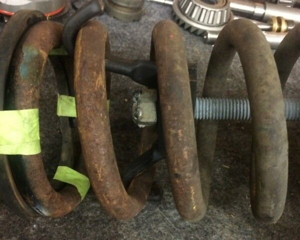

Well, I gave it one more shot tonight... At first the hooks slipped and the spring bowed out sideways but stayed captured.. Tried again and got it clamped down as tight as I could on the bench but still not short enough.. So, I hung the A Arm and swung it up until the spring hit the upper pocket (kind of halfway under the edge of the pocket). I jacked up the outside end of the A Arm a little bit, then tightened the compressor and kept repeating that until I got it compressed as far as I could.. I used the jack and the edge of the pocket to help compress the spring so there wasn't too much pressure on the nut on the all thread as I tightened it. It was still just a little too tall but I was able to jack it up until it popped into the K member pocket.. Problem is, the spring cushion that goes on top of the spring popped loose and is now sitting in there sideways, half on the spring and half off the spring... Don't know what to do with that other than to try and take it back down again and try to put the spring cushion back in..

Well, I managed to get the one back out even though the hooks slipped sideways due to the high degree of compression. What Spohn doesn't tell you is that you have to glue the spring cushions in first as even with full spring compression there isn't enough clearance to tape them onto the top of the spring. They also don't tell you that the standard spring compressors won't work for two reasons. One, due to having to fully compress the spring, the screw on the standard compressor will stick out the top preventing you from swinging the arm into place and it will hit the top of the upper spring pocket. Two, you can't use the lower set of hooks on the standard compressor since you can't get them low enough (with their tall spring pocket in the A Arm) on the spring to compress it enough. Unlike the standard compressor which compresses the spring from two directions and therefore can be tilted to angle it into the upper pocket, you have to compress the spring into the A Arm by bolting from the bottom and that means you can't angle the spring.
When I did this several years ago to put in new bushings and ball joints with the stock arms everything went together just fine.. This A Arm design makes it almost impossible to install. Spohn will tell you that all you have to do is compress the spring all the way and they slide right into position. Yeah right, easier said than done since there is not a spring compressor designed to do that safely... By the way, due to the depth of the spring pocket in the A Arm, banding won't work as you won't be able to get the band back out of the pocket once you cut it (and of course slam the spring into the upper pocket when you cut the band). After repeatedly compressing the spring as far as I could (due to slipping arms etc and and resetting the compressor) it now appears after taking the one spring back out that it is shorter by about a 1/2 inch than it was... So, now I have to buy new springs...
These may work just fine on the Spohn K member and they may perform just fine on a stock K member (if you can successfully get it installed), however, I do not recommend these to anybody. I don't know if Spohn will take them back since one is a bit scrapped up with prying it into position so I may just scrap them and lose my $500 I paid for them. I am concerned that I could damage the new springs by having to fully compress them so it looks like the best solution is to go back to stock arms...

After compressing that one spring multiple times, it ended up being about 1/2 inch shorter than the other one.. That was probably due to it bending sideways I guess.. Anyway, these springs have been in there since 2012 and are rusted from having the car on Colorado salted snow roads for 4 years so I ordered a new set.. Depending upon FedEX screwing up or not in the Portland distribution center this time, I should have them by this weekend but it could be another week.. So, waiting again to try and install these...
