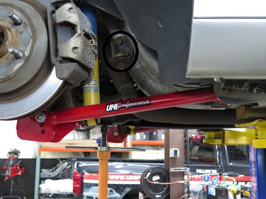

It seems one of my Sway Bar End Link Reinforcement Brackets is a bit bent.
Does anybody know of a bolt on replacement for this piece?

You mean the piece I've circled in this pic from the UMI website?
If so, then a junkyard car would be your best source, and I'd guess 100% of the 3rdgens you find will have 100% of those parts still on them. Not real sought-after. Otherwise, a junk dealer, like Hawk's, can probably pull one off of one of its parts cars.

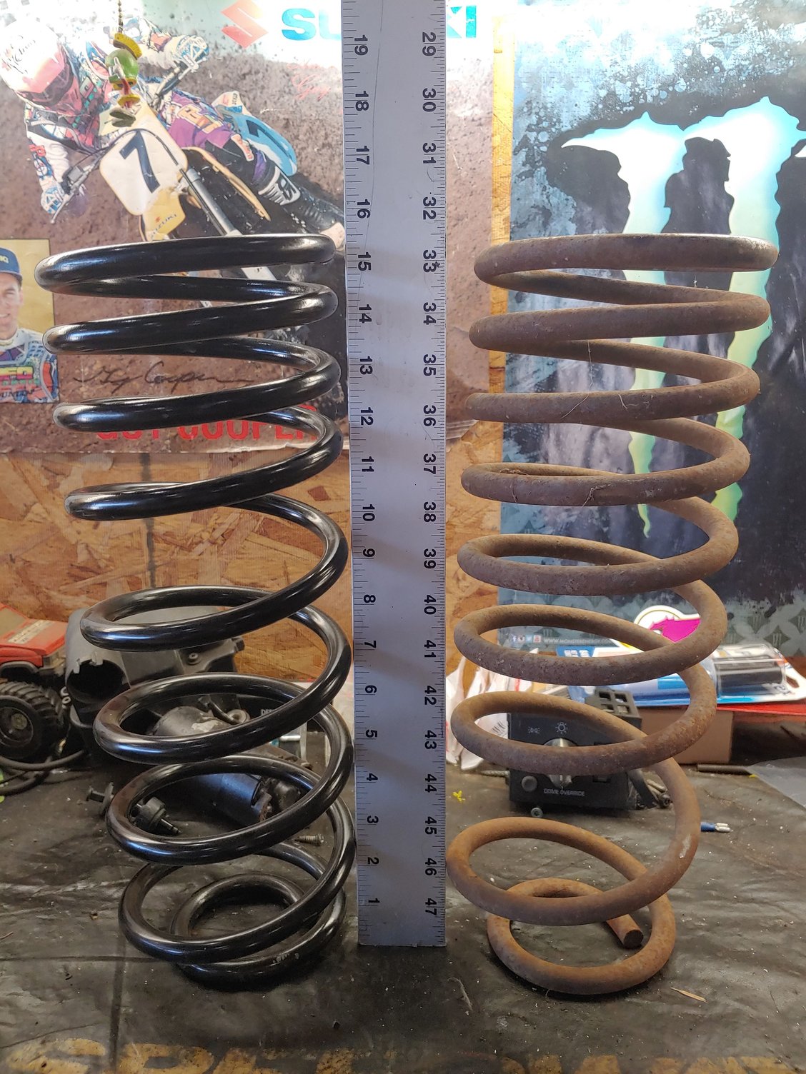

I finally got my springs out today and my AC Delco ones seem to be about 2 inches higher. I'll include a picture later tonight, as well as a look at how bent the drive side spring got after my little whoopsie lol.

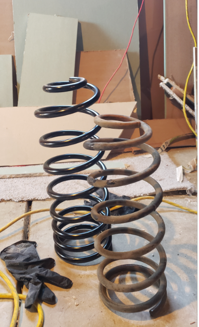

Interesting that you mentioned it lowered!
Here is a pic of the two springs...
I'm not sure if the PO lowered the car, although it sure looks like it. He certainly didn't replace any other parts if he did, except for a pair of Bilstein shocks.
Wonder what this will feel like...

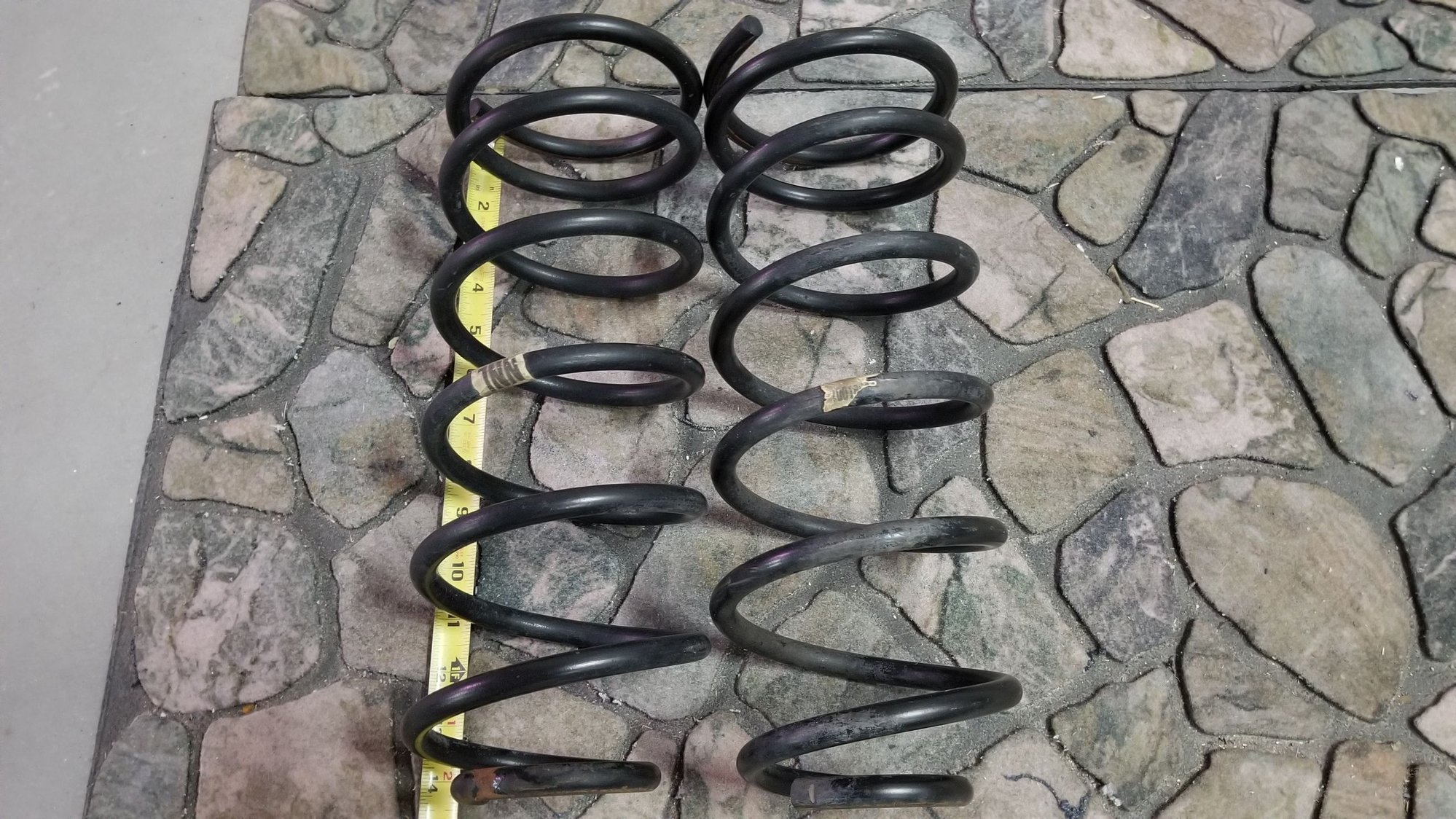

That's an OE spring, most likely your car's original spring. That dirty little disintegrating paper tag on one of the middle coils is the RPO tag. Gently wipe it off without destroying what's left of it, and you might still be able to read the code. That code should be listed on the car's SPID label, if it's still in the car, wherever it's affixed in a Camaro.
Here are my original WS6 springs, RPO NNL. Yours should be similar, if not exactly the same. Took these out a few months ago and installed weight jacks. First time they've ever been out of the car. They stand about 14-3/8" tall, and the ride height after nearly 34 years was still stock-ish, very little sag, if any at all. And paired with the KYB shocks that were installed in 1993, this shock/spring combo was still solid as a rock after nearly 28 years.

I measured the older spring at about 14in and the new one at about 15.5in.

1 month update, the ac delco rear springs are exactly what i wanted, they give you the Iroc ride and handling that i want, just like stock, you guys would not be disappointed.
