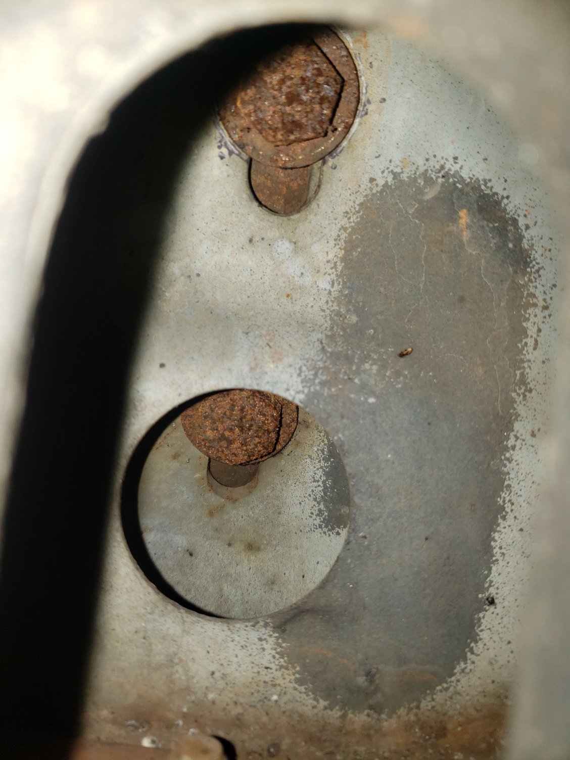

My question is how do I replace the idler arm without one in place or from the moog version to the a.c. Delco.As many of you know or will know, the moog idler arm is the wrong part for our cars. I picked up an a.c. Delco according to the part number from the forum post which discusses this topic at length.

isn't the new one supposed to match the originals angle ? Thank you.

Look through the slot in the frame for the marks that show where the old idler arm bolts were located. Install the new arm so the bolts end up in the same location.
