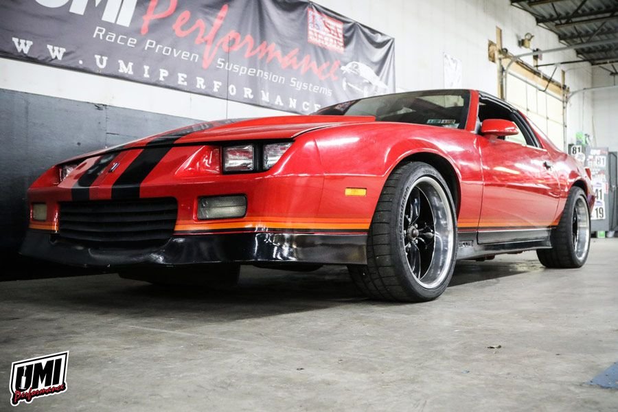

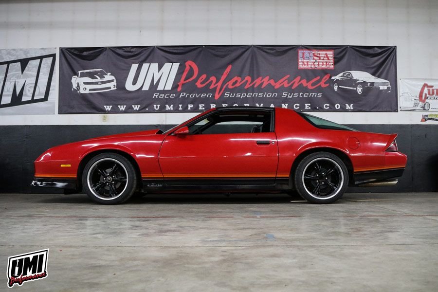

I bought these over the winter, havent installed them yet but seem to be a good all around lowering spring
https://www.umiperformance.com/home/...-1-5-lowering/

Thanks,
Those springs may be the way to go. I have headers and new exhaust so I have to make sure I don't scrape. These may be the best ones I've seen so far in terms of stance. I have KYB shocks so they go along with the recommendation. Any feedback on how they ride?
