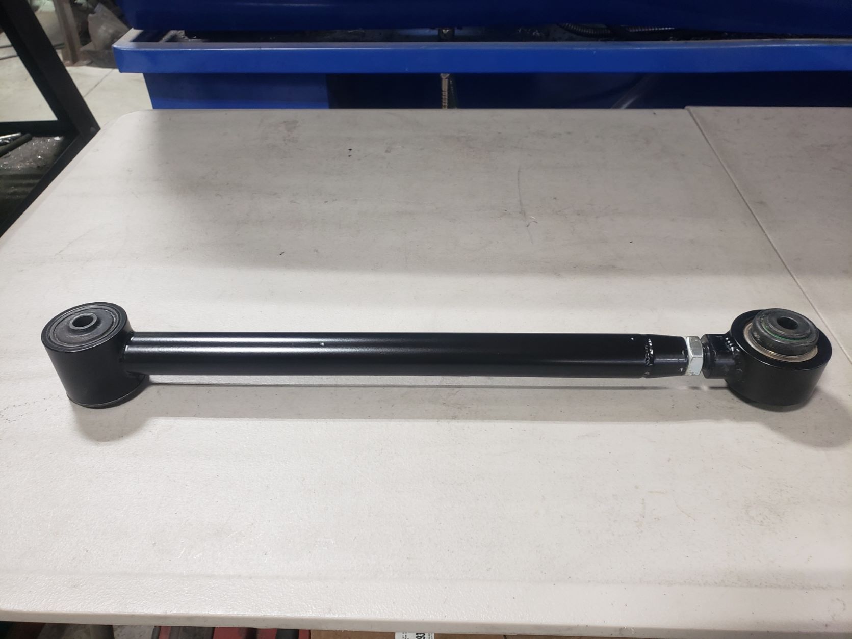

I used the Founders Performance with the 3 piece poly bushing. Best of both worlds. They have been on the car for 4 yrs now and still on the original greasing with no squeaking. These are smooth riding and great for handling IMHO.
I've never had a set of those in my hands, are all 3 parts poly, or is one or more of them a hard plastic like Delrin or nylon?

I've never had a set of those in my hands, are all 3 parts poly, or is one or more of them a hard plastic like Delrin or nylon?[/QUOTE]
It has been awhile since I put them in but I believe the center ball is a hard plastic. I used the "sticky" grease supplied with them to lubricate each piece as you assemble them into the control arm.

I've also been running the Founders 3-piece poly swivel arms with no complaints. Excellent quality. https://www.foundersperformance.com/...v=f24485ae434a

Had to post this...I had the poly and the snap steer was terrible- founders poly poly. Sure it hooked well with no wheel hop and under light corners handled fine, this was a 4th gen w/ 285/35 18`s all around with umi 2 inch drops and bilstiens so plenty capable. It ended up getting so bad on high speed corners I had to make a change. I had these built- they are not for the light of wallet BUT these solved every problem I had you see...I live off a dirt road so open bushings get blasted with clay dust..so grease is out of the question. I found a local place that was building these arms for another chassis and had them build a set to my spec...these totally changed the car into a corner eating on the throttle pass you in the corner car. The specs:
The rearend side uses a cross axis ball joint, this is a German made harden steel cross pin w/ 1/2 ID 2.5 wide, the joint is totally sealed and offers 22.5 degree of articulation, this is the magic of the set up. The rod end or bushing cup is chrome moly tig weled with an adjustable threaded end, mild steel 3/16 wall tubing then a 2.5 inch high durometer bushing. So everything is sealed weather tight, the bushing needs no grease and they ride quiet down the road and put down the power in turns..the one word I see missing from this thread is Articulation...that is what the rear has to do in turns, it cannot bind , if it does it is lifting pressure off the tire, hence why it skips easily over a bump in a turn. I found out long ago what bind can do, in my drag car an 85 third gen, the spohn torque arm has a shackle at the cross member, there is a lock nut on there for a reason, I had it torqued down, the car would launch off the trans brake great but immediately fall on its nose after the initial hit..found that tight bolt and loosened it so the T/A could go fore and aft during suspension travel...right out of the high 1.3`s to low 1.2 60' times with that adjustment
I can have these built if anyone is interested, they made such a difference coming from poly I had thought for a while to offer these but there are so many trailing arms on the market and a few offer similar function but competition is really aggressive in this market so I`ll just stay in my own wheelhouse.
