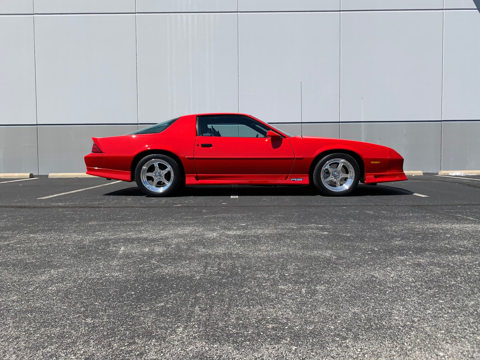

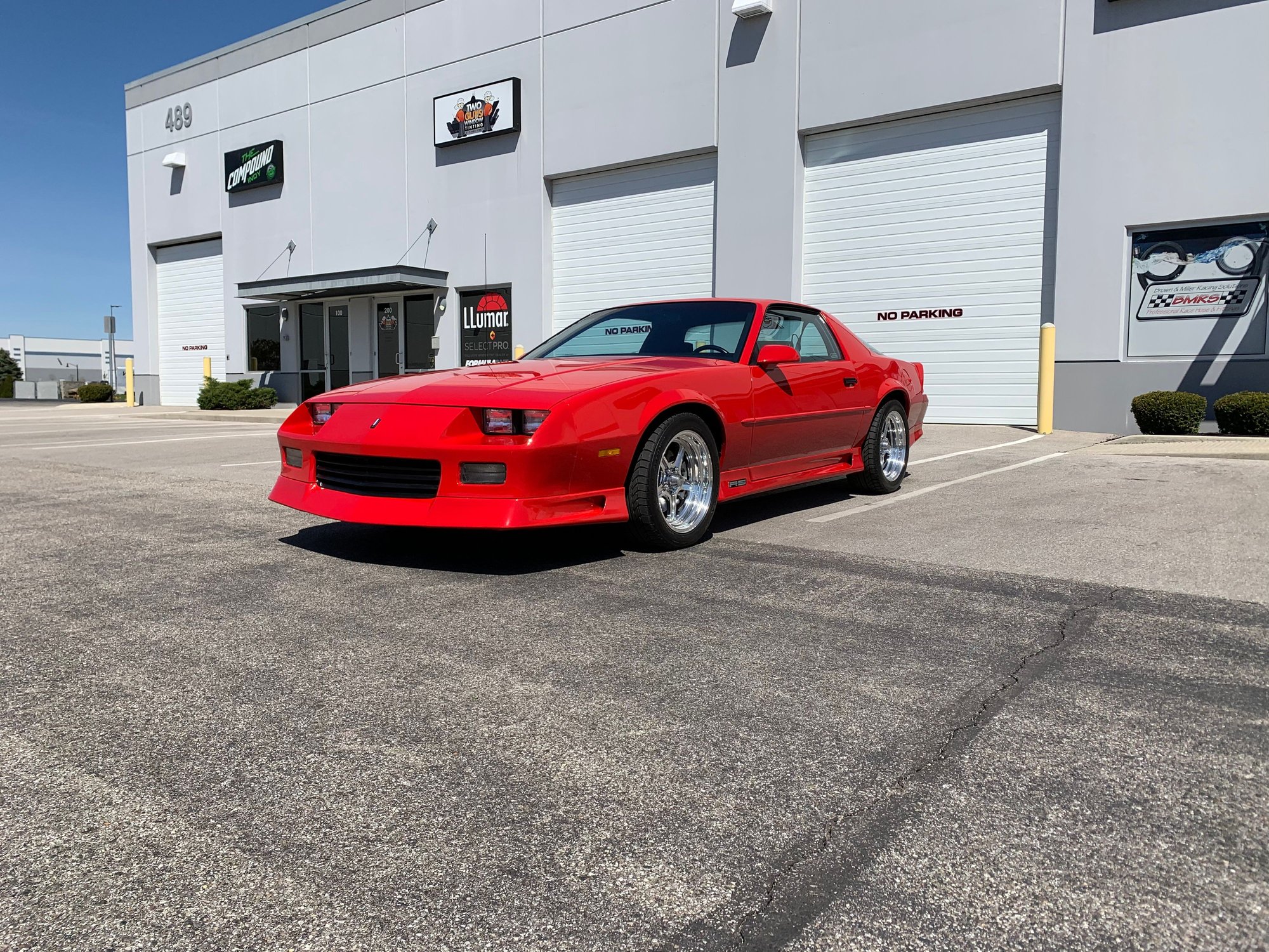

I cut a 1/2 coil off the factory front springs on my 91 Z28 and put them on a 92 RS. I removed the isolaters on the rear springs and slid some heater hose over the end of the springs to prevent squeaks.
Every car will be a little different when cutting springs depending on the amount they are already sagging and which version of factory spring you are starting with. 1/2 coil is a good place to start and I wouldn’t go much more than that, the spring rate increases and the ride gets rougher as you shorten the spring.

Wow, that's a nice stance...

Thanks, I’m happy with it. I would use different springs for performance use but for a street cruiser it’s perfect.
