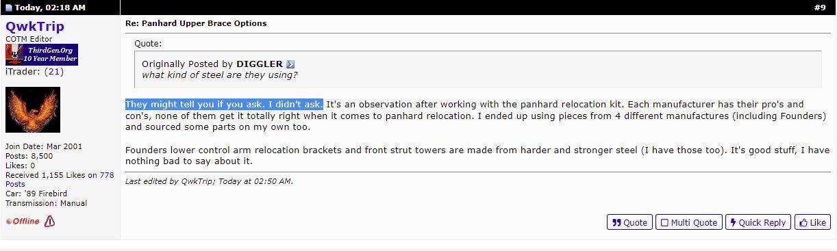

Originally Posted by DIGGLER
what kind of steel are they using?
They might tell you if you ask. I didn't ask. It's an observation after working with the panhard relocation kit. Each manufacturer has their pro's and con's, none of them get it totally right when it comes to panhard relocation. I ended up using pieces from 4 different manufactures (including Founders) and sourced some parts on my own too.
Founders lower control arm relocation brackets and front strut towers are made from harder and stronger steel (I have those too). It's good stuff, I have nothing bad to say about it.

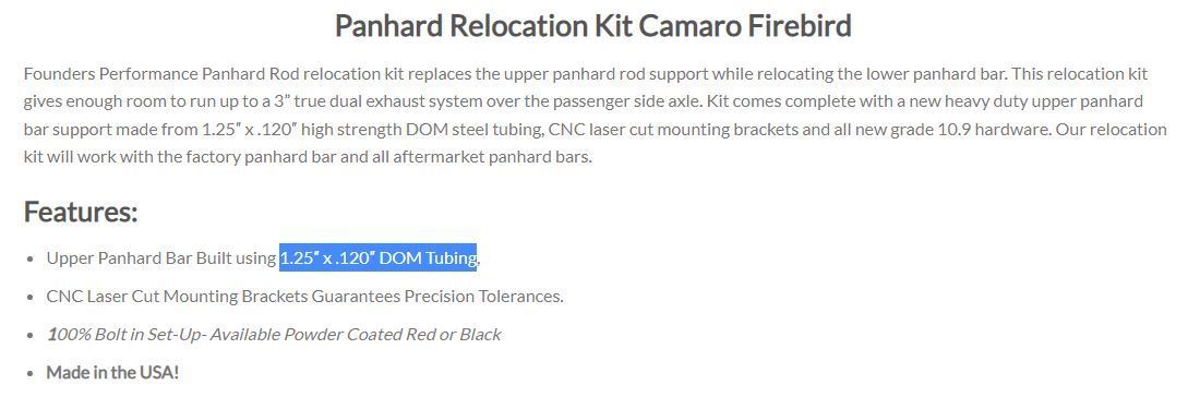

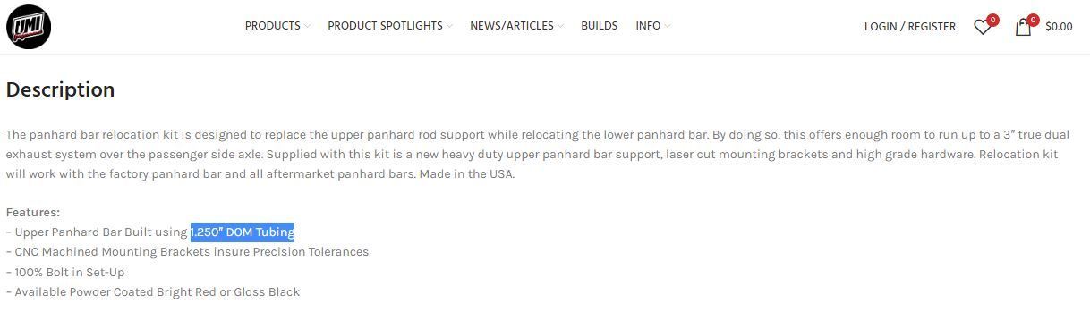

They both use 1.250 DOM tubing with only Founders stating their wall thickness but I will go out on a limb and say UMI uses the same wall. Most commonly DOM tubing is 1020 and I highly doubt either vendor uses 1026 in this application. So unless your a metallurgist with proof you have no leg to stand on, as I said theyre the same upper panhard bar
